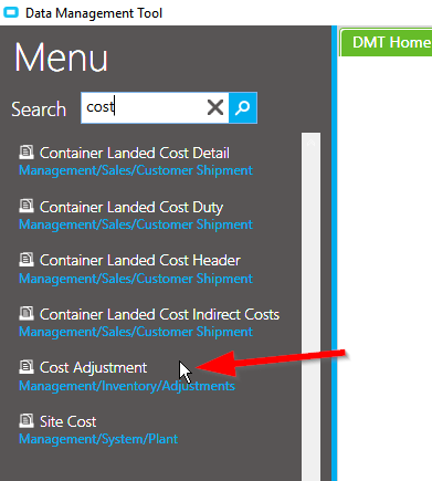

Yes you can, there is a menu item for cost adjustment. Follow the template and you can make whatever adjustments you need to.

Yes, you can update the Standard Cost using the Adjust Cost command in the UI or via DMT.
