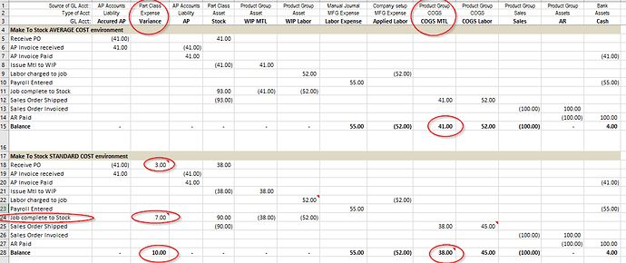

The difference between the budgeted value of the job (standard cost) and the actual cost of the job goes to “variance”… this variance is part of your cost of production, but is classified differently. Instead of posting the variance directly to the FIFO Value, the standard cost goes to stock, and the variance is immediately written off as variance.

When you close the job, and do a Wip/Cost Capture process, any difference between Standard and the Actual charges to the job will be charged off to Variance.

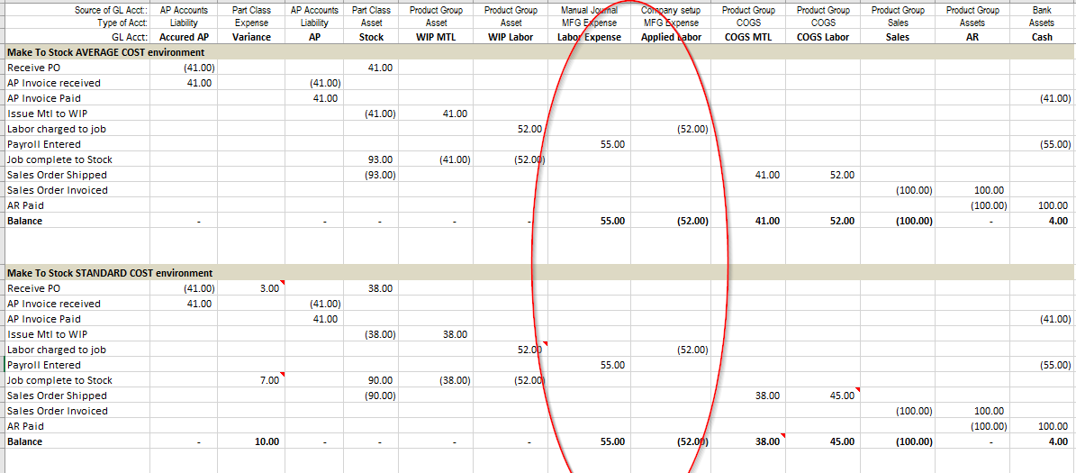

Check out this tool that I use to teach the difference between Average and Standard cost:
It should also be noted that there are different kinds of variances… the Std Cost variance is directly captured as discussed previously… But an example of a “variance” that does not have a variance account would be a Payroll Variance (also illustrated by this spreadsheet)… When Payroll is paid, it is a manufacturing expense which happens on a different day then when the “Applied Labor” is charged. Applied labor happens when hours are charged to the job (times the Resource labor rate). payroll will almost always be different than applied labor due to Breaks, down time, etc… but note that three is a difference between the Payroll and Applied Labor… this difference is a “variance” of sorts… it is “unapplied” labor… it is part of the manufacturing expense but is not directly part of COGS. This spreadsheet example is “too simple” in that it does not show “Applied Burden” (aka Overhead) which should theoretically apply all other manufacturing expenses to WIP as the job is done… thats when accountants get to look at the over/under applied labor/burden to determine if they need to increase/decrease the labor/burden rates that will be applied next period.
