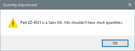

Also, SSR looks at company part settings, even though transactions are actually based on the site. Quantity-Bearing is a big one to make the report maddening.
Also I learned the other day that the SSR ignores Sales Kits.A few things wrong with that. (1) Kits can have inventory, even if they shouldn’t. And (2) if you are like us the part is a kit in one site but not another.
How does the QOH of a Kit get changed?
Customer Shipment Entry requires specifying the location of the kit components.
Trying to do a Qty Adjust of a SK item (even one that is Qty Bearing), gives:
Well, one simple way is to have inventory of it and then change it to a kit. Not a good idea, but I just tried it and it works. That was the site setting. And the company setting can be anything at any time.
