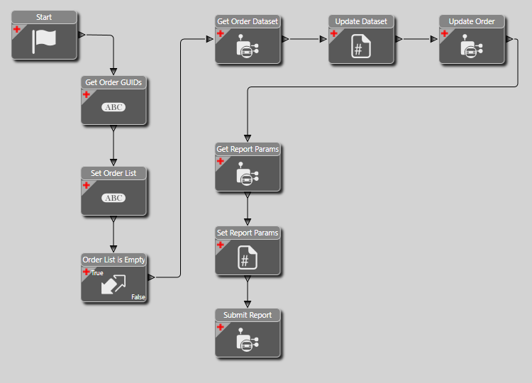

Hmmm, I did this and it worked:
So I think now we know what happened with the other.
That BPM (SysAgentSched.Update?) method must be inside a transaction already, and causing issues.
