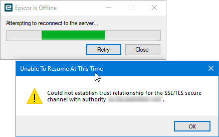

when I hit retry on attempting to reconnect to the server after logging in I get this, I guess it is the cert right?

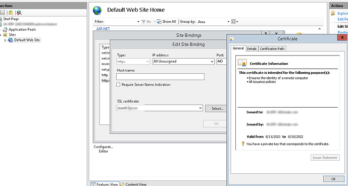

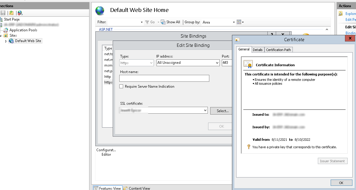

so, do I bind the certificate to the site, because there is one in there?

Last error is about certificate not trusted.
You have to use either certificate, issued by some known certificate authority or learn how to establsih trust for the self-signed certificate.
It is essential when switching to https.
Yes. You bind it to the site in IIS. Make sure the cert that’s selected is either a valid CA cert or is trusted if using a self-signed or internal CA.
Thank you Olga, so I have the certificate in the Trusted Root Certification Authority, are you saying there is more I should do?
We do have that portion
It would need to be on every machine that’s going to access the app. You can push it out with a GPO. We use a signed CA wildcard so we don’t have to add anything since it’s already in the Windows trusted root store.

here I wrote how they are checked
Is it a self signed or CA cert?
Self signed
