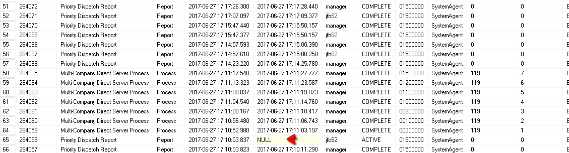

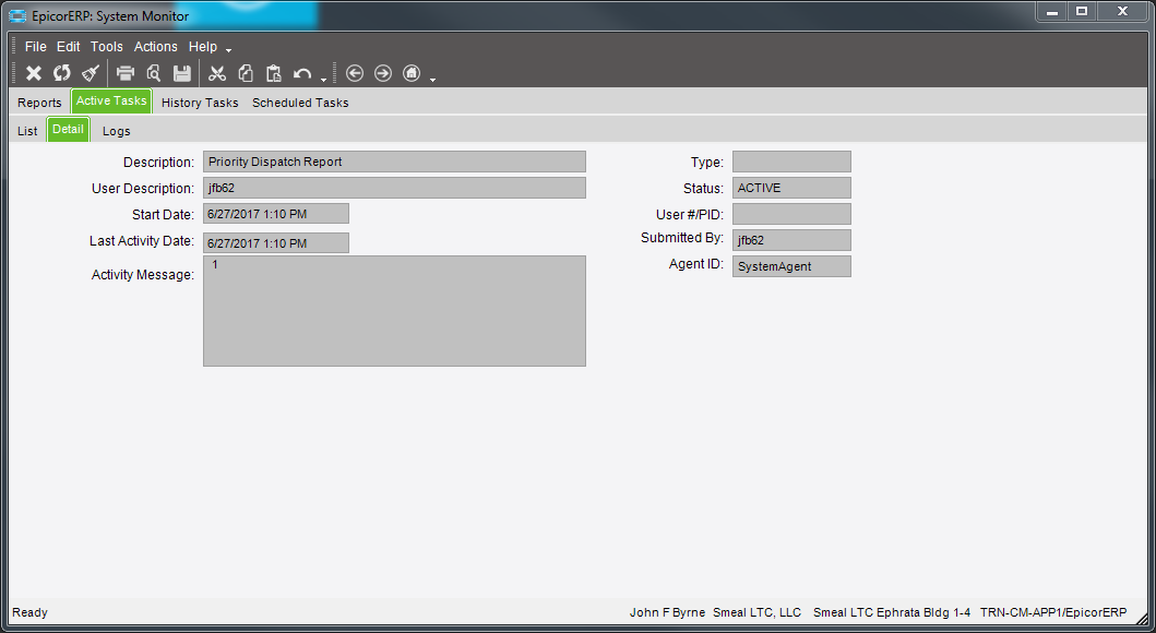

Does anyone know what would once in a blue moon cause the SysTask record to have EnteredOn to be NULL - which causes the report to basically sit in ACTIVE…
Assuming the Agent uses the EnteredOn as a time to poll tasks it should work on… it being NULL leaves it hanging in ACTIVE… No errors in logs found.
Its stuck and it happens often and I cant seem to isolate the cause… I can run it again and it works… but tomorrow there will be a time it will fail again… SSRS is running, SQL is running.
If i look into the ReportServerTempDB – the issue carries over… I just cant explain why - once in a blue moon and then you hit print preview again; and it works. Magic.

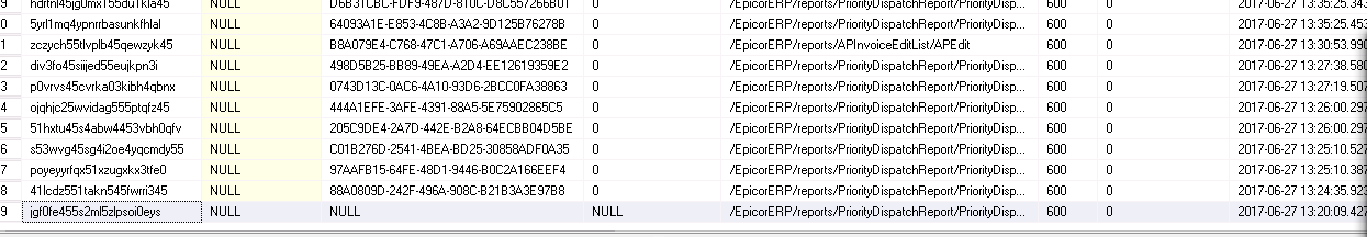

SnapshotDataID Column is Null
yet a Snapshot exists in SnapshotData.
