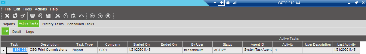

The second Task has been running since 8:45 ( it is now 9:36 )
And it is just sitting there in the “Active” queue however it is nowhere to be found on ANY log. That is this task, and this task number show ACTIVE in the System Agent but have somehow not made it to any log. ServerLog or Event Viewer on either of the Task Servers, it is like a ghost.
Interestingly enough I can submit other tasks and they work fine, AR Print etc, they all work. But this particular Task is just a an “ACTIVE” ghost. No Error Entrires in Event Viewer under Task Agent or App Server Node, not a whisper of them in the ServerLog NOTHING… It is as if this Task was Marked ACTIVE and never actually started.
Does anyone have any ideas here? I’m about to blow a gasket!

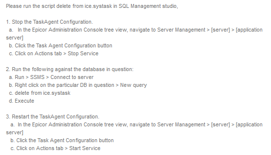

Here are the instructions the Epicor tech sent me:
I try to be very careful running this but here are a few SQL programs I keep handy because I’ve had to use them a few (maybe 4) times:
Maybe a clean-up of your Ice.SysTask table will help? I’m not sure where you can begin to figure out why you are getting these “GHOST” processes if you don’t get good logs. I think ours have mainly been caused by our AppServer memory usage suddenly growing out of control and no choice but to Recycle the AppServer during the time that the (MRP) process was running. Maybe you are having some connection issues or maybe there are some Timeout Settings that you can adjust? Just thinking out loud… it is interesting to me that it started running and logged an entry after an hour and a half. :ghost:

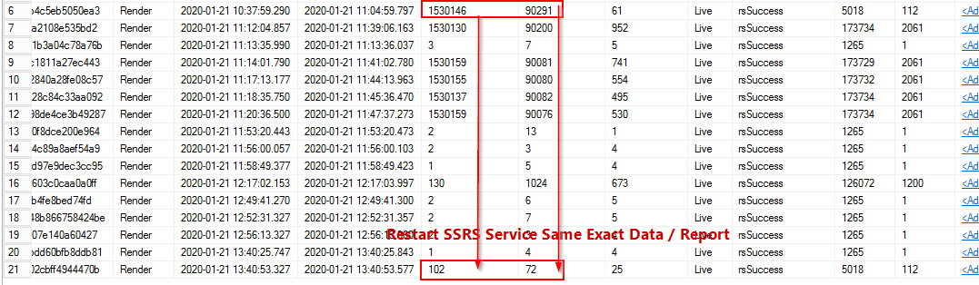

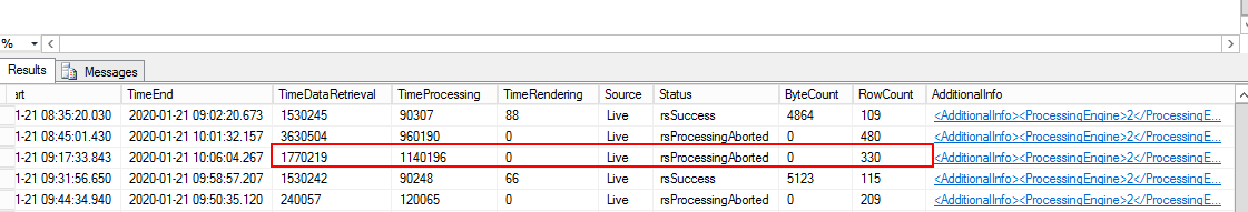

So, After much more digging through endless logs I found this
Notice the RowCount vs TimeDataRetrieval and TimeProcessing… It is taking an hour or more to retrieve 300 records from the Intermediary Database. However the plot thickens because once I restart the
SSRS Report Service, I can run the same report with the exact same number / amount of data in seconds…
So it appears something is happening that is causing SSRS Report Service to… get bogged down and then it can’t figure out how to perform? Any ideas?

Did you know SSRS keeps some very nice logs of what it is doing? Basically there is an ExecutionLog3 SQL view that you can query that tells you all kinds of stuff. I’ve been able to figure out SSRS specific issues from that in the past. You get information like what query was run, how long it took and now many rows it returned. It’s been a while since I’ve played with this but it is the next place I would go and is already on and available to you!
https://docs.microsoft.com/en-us/sql/reporting-services/report-server/reporting-services-log-files-and-sources?view=sql-server-ver15
Yes @JeffLeBert! That’s how I figured out the above DataAccess time vs render time etc
What I seem to not be able to find an explanation for is why the report with the same exact data will behave one way now and a different way later ( gets worse with use, I’m leaning toward a memory leak in SSRS itself ? )
