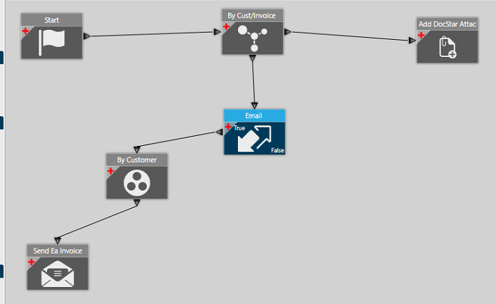

Post a screen shot of the BPM you have to send emails. If you joined your ttTable to your order or invoice table with 5m rows, that would be instant death.
I’m also curious about the posting BPM that uses the Autoprint.
If I recall correctly, printing selected Invoices is very difficult. You can either print one invoice, or the whole group. So if the BPM is set to print them one at a time (based on your description that certain conditions exist on that invoice), it’s going to run slow.
You’d be better off just have the posting process print the whole AR group, and let the Routing style do the selection/filtering.

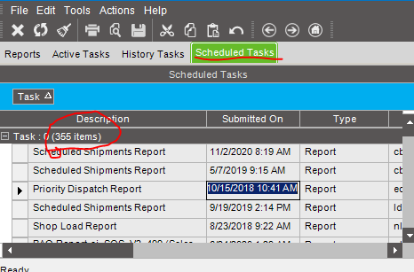

Plus users have about 250 emails of reports scheduled, multi-company is running, EDI, 50 users have widgets pinned that auto-refresh every 5min by running various BAQs etc etc…

Epicor is not a very solid system in terms of performance, if performance is such a big problem i would say you need to start looking into scheduling processes to be executed off hours, i.e. cos/wip, mrp, posting, order generation etc. etc. you need to look into that and maybe there are some processes that you will be able to take off your server’s hands. I have seeing this time and time again, Epicor will only recommend you to add more hardware, more juice, more x more y but will never acknowledge the fact that the software cannot handle the load. you will probably end up spending quite a bit of money in consulting and hardware with no real results.
