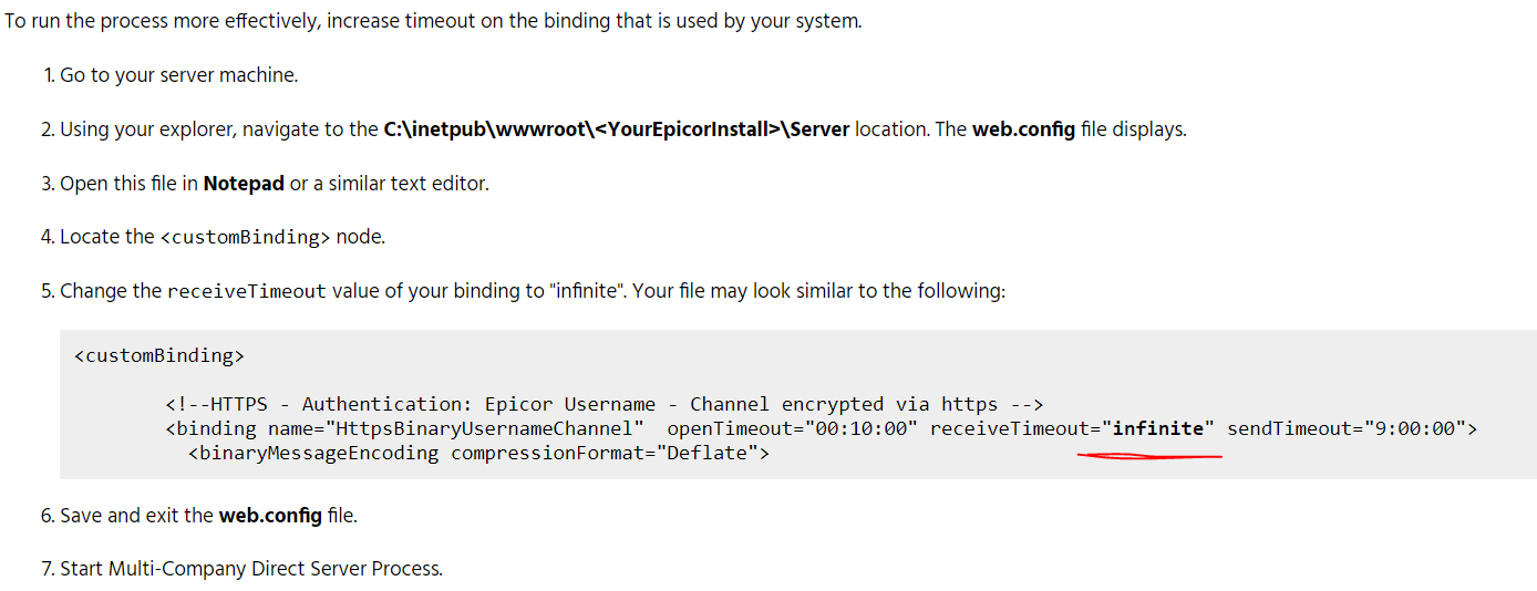

Maybe the fix is INFINITE :smiley:
Photo Credits: Multi-Site Technical Reference guide

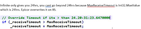

Infinite doesn’t work it limits you to 24hrs, its hard-coded in Epicor Hosting Dll. FYI
@JeffLeBert just an FYI that Epicor states in their help you can use Infinite for Continious processing task, but in your dll you overwrite it.
