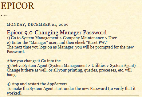

Been looking at this post for help, but not finding a solution:

I’ll bet you this is key. If they can change it back temporarily to test I bet it will work. E9 has been a long, long time ago, in a galaxy far, far away…but I found this, does #3 help at all?
Thanks Heather, I’m afraid that’s not the issue.
The password they changed was the server admin password, the Epicor managers password has not changed. But I did have them re-enter the password to be sure.
