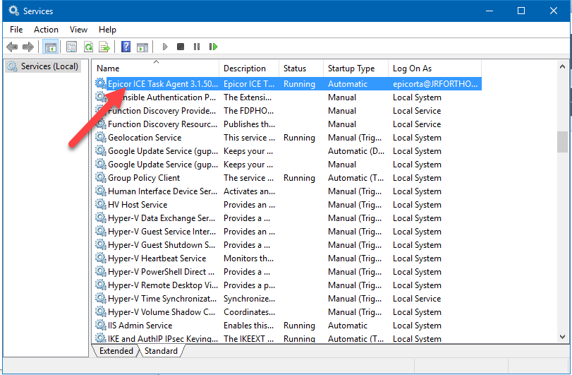

What is the version of E10 you are running ? Can you send me a screen shot of your taskagent properties?
Have u changed password of the Logon Username of ICE task service or ur epicor application manager’s password ?
Recheck if changed and not updated in both places…
