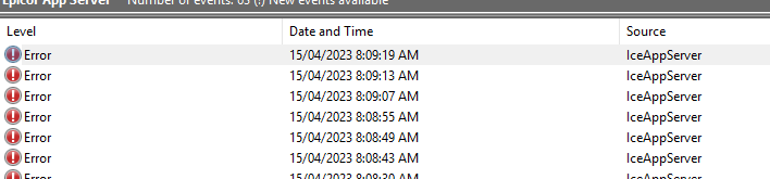

Hi Experts
I appear to have a task stuck in a loop. It does not appear in the sys monitor and still persists after a restart. This makes me think its somewhere in the DB and comes back to life after the restart, but I don’t know where to look. It has been created by a UOM issue but ignore that for now.
I also cannot find the C:_Releases DIR. I assume this is temporary.
The error is in the event viewer as below
Any suggestions would be great to hunt down and kill this process / task.
Description: An error occurred while invoking Epicor function:
Description: Shipped Qty has a value of 20.99500000 , the UOM allows for 2 decimals. ()
Program: Epicor.Functions.Core.dll
Method: ProcessRecordedExceptions
Line Number: 143
Column Number: 21
