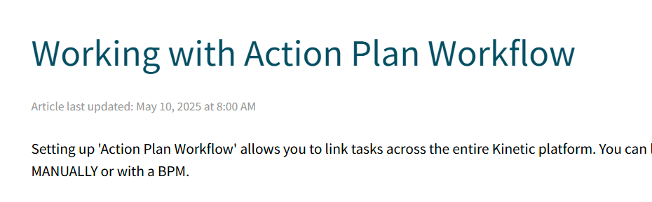

in 2025.1.5+ there is a new feature called .. Action Plan Workflow which is a more generic way to attach a set of tasks to (anything)
Got a handy link to anything on that?
I’ve been waiting to see what this is in detail. I know Tim has been hinting at this for some time now.
Not sure how handy it is since its from help, but if you get your cookies in place… then go here
https://erphelp120100.zendesk.com/hc/en-us/articles/36506737993869-Working-with-Action-Plan-Workflow

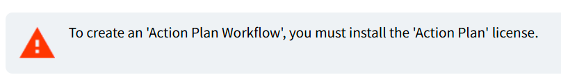

Dang! I need to setup some task lists for various things and I was excited…but for only a minute :frowning: until I saw @klincecum post. Should have figured there would be an additional cost to it. :woman_facepalming:
I doubt it will be very pricey someone call a cam! And find out for us all
