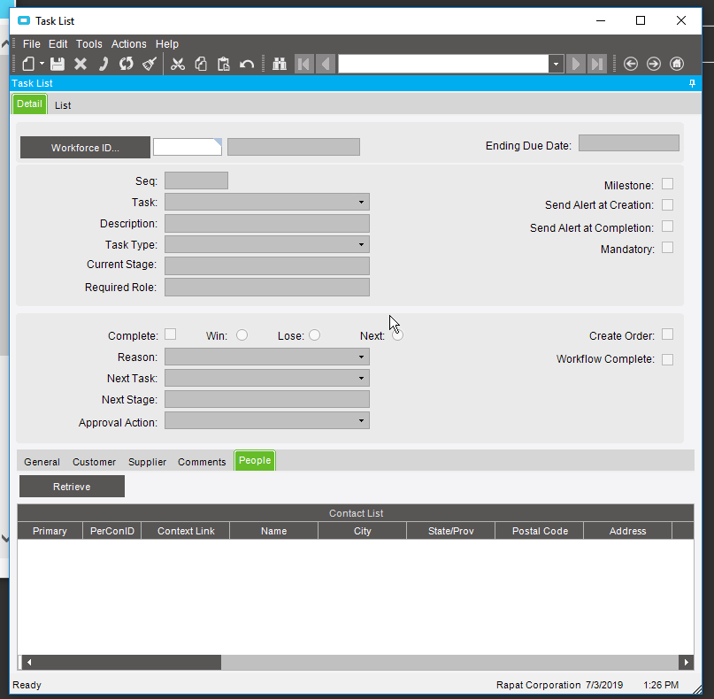

BTW Task list is what you are looking for in Epicor. I don’t use it, so you’re on your own on that one.

Our CSR’s can route a quote to Accounting, Engineering, or Production (or others) as they see fit and we currently do that by having them just add the task to the quote. But since you have to tie that task to “someone” and we wanted them to be available in a ‘queue’ for our folks in those departments, we created a generic workforce id with the appropriate people as Authorized users. That allows each real person to open the Task List and show tasks for the generic person and process them like it was a queue. It’s pretty simple in the end. Couple that with some notifications and everyone is more or less happy, and we can track the ‘workflow’ of a quote inside Epicor by looking at the last active task for that quote.
We even did a custom BPM on Tasks to fill two UD fields with date/time created, and a dashboard for Tasks so we can sort/filter/prioritize them a little better based on product, customer, date/time in the queue, etc.

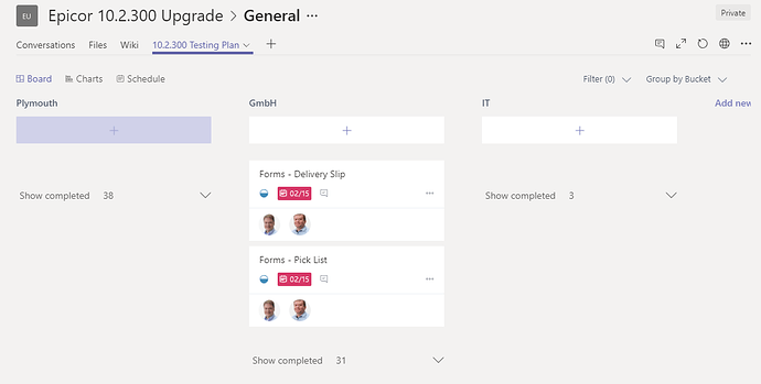

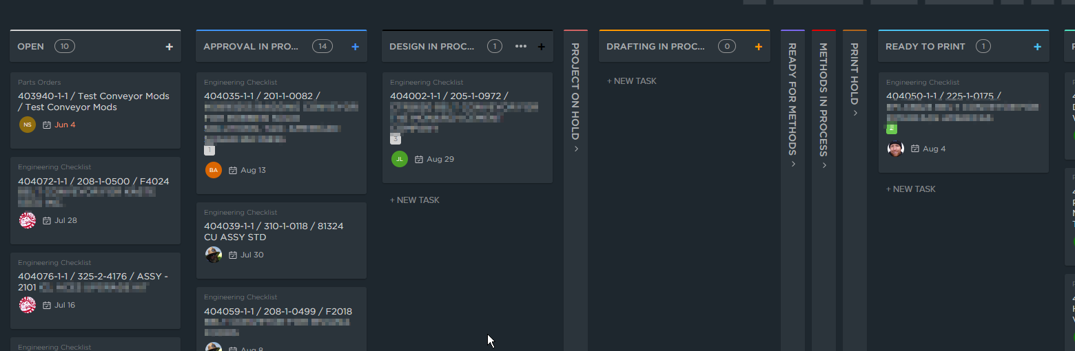

Brandon,
Is this view from epicor or within the clickup app?
I would be interested to use the gantt feature for some planning of resources (human ones) if it can be customizable enough (still to be looked at when time permits… :wink: )
looks promising…we mostly use SmartSheet for our big project planning…and moreover…a good reason to finally learn to use REST !!!
Pierre
That’s from clickup. They have gantt charts but we aren’t good enough at date management to use them effectively.
