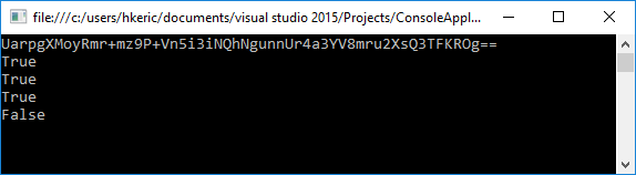

            // Create a New Hash with password manager
            Console.WriteLine(ComputeHash("manager"));
            // Lets Validate all these possible hashes against Password manager (one-way hash)
            Console.WriteLine(VerifyHash("manager", "46uIY6/nQjHL5mX1KeE/7NtEXD3MIOblGxpVRH5ZWXNORGsNwT3WHg=="));
            Console.WriteLine(VerifyHash("manager", "JIzKviG6ZG5rE52KOeKEg4AvPnU72FOUQ0y7y/R8h8GZNQaV2G+GHw=="));
            Console.WriteLine(VerifyHash("manager", "tjk/TfHesmjnhq7NcUbCkfQKJnqfV7Q2mJRG6hwYRD8xGIofA6tGIQ=="));
            Console.WriteLine(VerifyHash("WRONG_PASSWORD", "tjk/TfHesmjnhq7NcUbCkfQKJnqfV7Q2mJRG6hwYRD8xGIofA6tGIQ=="));
            Console.ReadLine();

        public static bool VerifyHash(string password, string hash)
            byte[] saltBytes = new byte[8];
            byte[] buffer = Convert.FromBase64String(hash);
            int x = 0x100 / 8; // SHA256
            if (buffer.Length < x)
                return false;
            for (int i = 0; i < saltBytes.Length; i++)
                saltBytes[i] = buffer[x + i];
            return (hash == ComputeHash(password, saltBytes));
