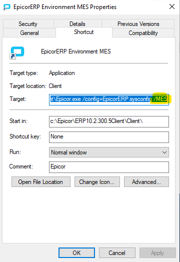

I think you mean MES, but all you do is add /MES at the end of the command in the shortcut.
