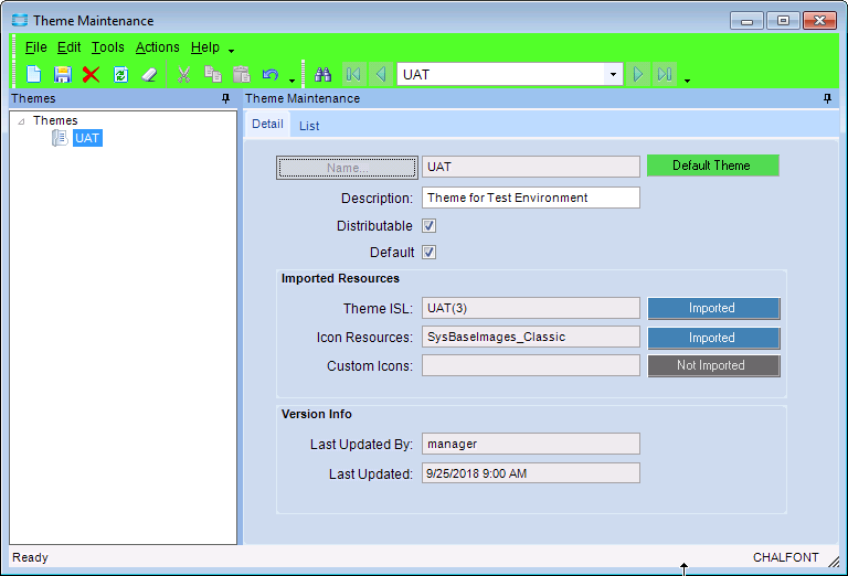

I also change the default theme. I made one that has bright green backgrounds to instantly let users know they are in the test db.
Create the Them in your live company, then you only have to set it as the default when you copy the Live Db to Test DB
I do the same thing. I dont want users accidentally testing things in Prod.
Or wasting time entering real info in Test. :slight_smile:
Yes, we use color coding.
