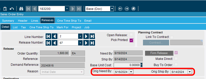

On my Order Entry > Releases > Detail screen there are 2 fields labeled:
  • Orig Need By (Mapped to OrderRel.Date05)
  • Orig Ship By (Mapped to OrderRel.Date04)
Those fields seem to reflect exactly what they say, the original dates.
The issue I am having is that for the life of me I cannot find where those fields are being set at. I have looked through all of the usual places, and am coming up dry.

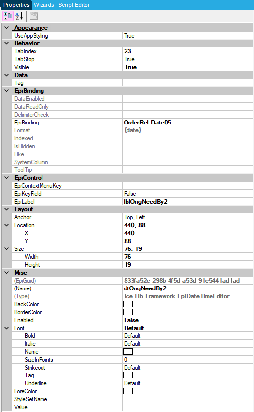

Here are the properties for one of the controls. The other is setup the exact same but for OrderRel.Date04 instead of OrderRel.Date05.

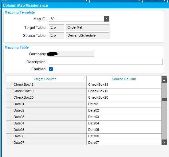

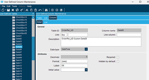

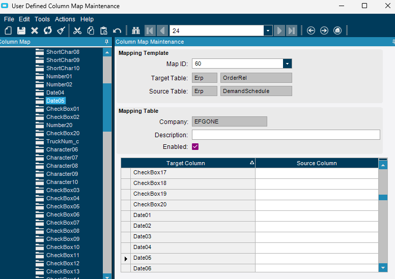

I looked in the User Defined Column Mapping as well, but that was not any help.

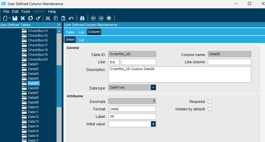

The UD Column Maintenance proves to be just as unhelpful.

Echoing what others have suggested, are you using EDI and Demand Entry? If so, you can look at UD Column Map > Map ID 60 to see if Date04 and Date05 are mapped.
You can also do a BAQ to query DemandSchedule table to compare the field values of the DemandSchedule record to the corresponding OrderRel record.
It does appear that these are set on both EDI and non-EDI orders.
That was in my initial post. There is no mapping for them. Good thought, though.

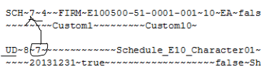

There is a mapping file titled like this that defines where they go.
Kinetic_InboundEDITransactionFileMappings_2021.1
if you have UD fields in the app file they will be like this. SCH are releases, so the UD record 8 relates to the SCH record 7.
