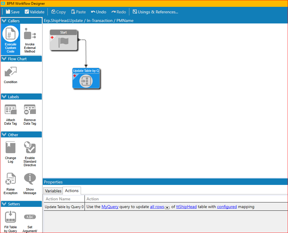

Alternatively, you can do a BPM(Data Directive for your case) on ShipDtl and use “Update Table By Query” setter to set the field coming from OrderRel.
I did same thing for one of the custom field for project manager but I am sure you can do it for Need by date field.

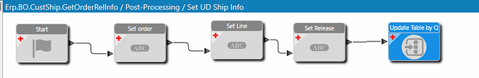

Assuming the field appears, I would put this post processing on the method GetOrderRelInfo.
Three set variables to ShipDtl.OrderNum, OrderLine and OrderRelNum
Then query

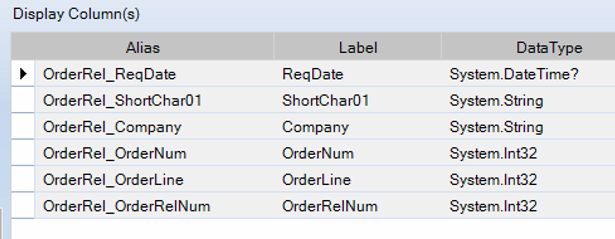

Columns. I am using ShortChar01 since I did not add a field for this example
Set relations and bind your field.
When you say set variables is that a Set Argument/Variable then selecting new under variables and typing in “ShipDtl.OrderNum”? then repeating with OrderLin and OrderRelNum? When I try to type it I basically can not move forward.
Variables. they can’t be real fields
Set Order to ShipDtl.OrderNum. Same for line and release. This is so you can use them in the lookup query.
and in the display columns from the query should I be grabbing the NeedByDate instead of the ShortChar01 from OrderRel since that is what I am binding to my UD in ShipDtl?
Yes.
That all worked! thanks for taking the time to help me through it.
