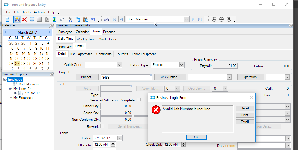

I am try to look into using the projects in Epicor more and am testing time entry. I would like to see if you can enter time to a project without a job but I am getting this error.

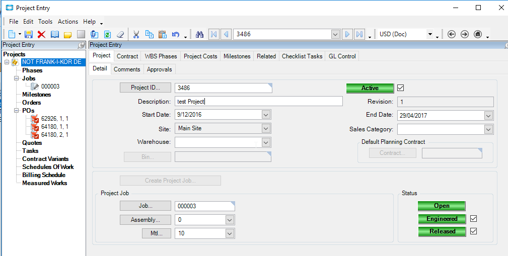

I tried to add a job (and click engineered and released) to the project as well but get the same error. Also tried with Approvals Required on and off in site configuration.
I figure I must be missing something somewhere…?

The project has no WBS phases and the job I made was on the project itself…

We are on E9 and to be honest I have never tried just having a project with no phases. I was under the understanding that the job on the time entry related to the job on the phase. I also thought that the job number on the timesheet form was not populated until you selected a phase and operation. So at a minimum you need one phase with one phase job operation.
That is at least how our system is configured.
I’ll give that a try in the morning, thanks.
Simon is correct.
For labor capture, you need at least one WBS phase and you need to use the “Create WBS Phase Job” functionality on the WBS Phase table.
This will create a job of type Project. I do not believe linking a Manufacturing job to the Phase will be enough. If your intention is to use a manufacturing job, that is tied to the phase, then you would do a standard Production labor entry instead of a Project time entry.
