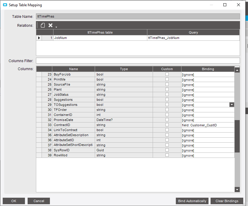

I added the CustID for a given make-to-order job to the Time Phase using a no-code BPM and a no-code customization, and ‘borrowing’ the ContractID field which we never use. You could do something similar for your checkbox, with the additional customization of a row rule to highlight the row.
The BPM is a Post-processing on GoProcessTimePhase, which is what fills the time Phase data.
Here’s the query to find the CustID
And here’s the mapping that stuffs the CustID into the ContractID field in the displayed data.
Now the CUSTID shows up where the ContractID would be, and the only customization needed is to relabel the column heading from “ContractID” to “CustID”.
