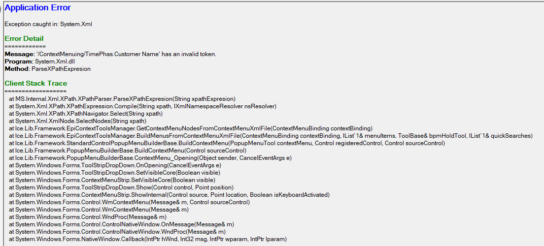

Thank you for this. It was a life saver. This seemed like such an easy ask but there’s just no good way to do it given that the whole form is basically a grid and uses a data table that is not a traditional table that you can access like Customer, OrderHed, etc.
Having said that, one thing I ran into is that if you right click on a cell in that column, you get an error.. see below. I am going to try to figure it out but I thought I should post here because anyone else in the future who follows this may run into the same issue.
EDIT: I might have something wrong in the way I incorporated it into my customization. I am having weird stuff happen when I click anywhere on the form. Not just right click in the grid but adjusting column widths, clicking any other field. Seems to cause it to switch sites… I need to look into it. Maybe I screwed it up.
‘/ContextMenuing/TimePhas.Customer Name’ has an invalid token.
