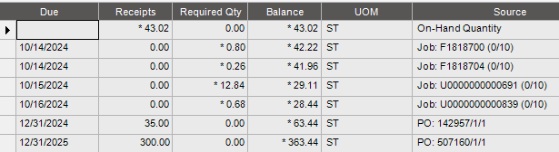

When looking at time phase for a part, it shows an On-Hand qty of 43.02 (43.0215), as shown here:
This is also reflected in Erp.PartQty.
But when I look at PartBin, I am showing -48.167.
What would cause that discrepancy?

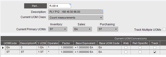

If I am understanding the UOM Conversion Table, it looks to be a 1-to-1 conversion:
Yup, 1 ST = 1 EA. So the math says then that you have -48.167 + 121.000, which comes out to 72.833.
