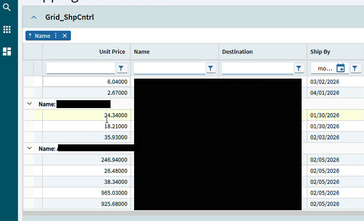

One of our Shipping DBs, which users have grouped by CustomerName, now expands all grouped records when expanding one and selecting a record underneath. It’s weird.
Expand one group, select a record:
It expands all groups:

Same here, seems to be a new behavior since the upgrade

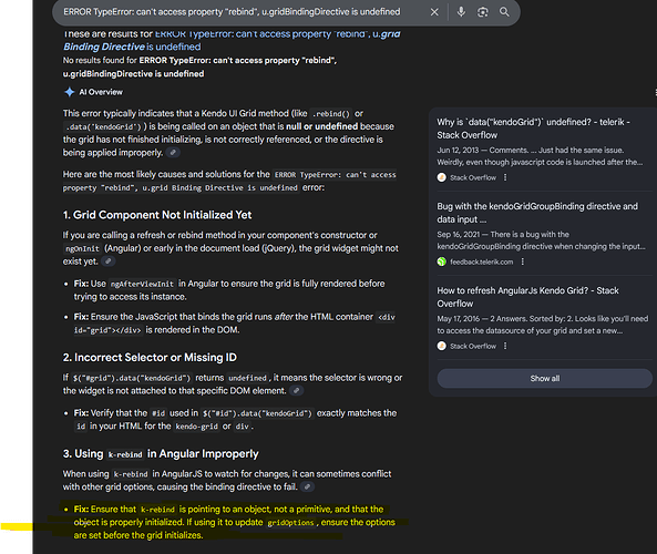

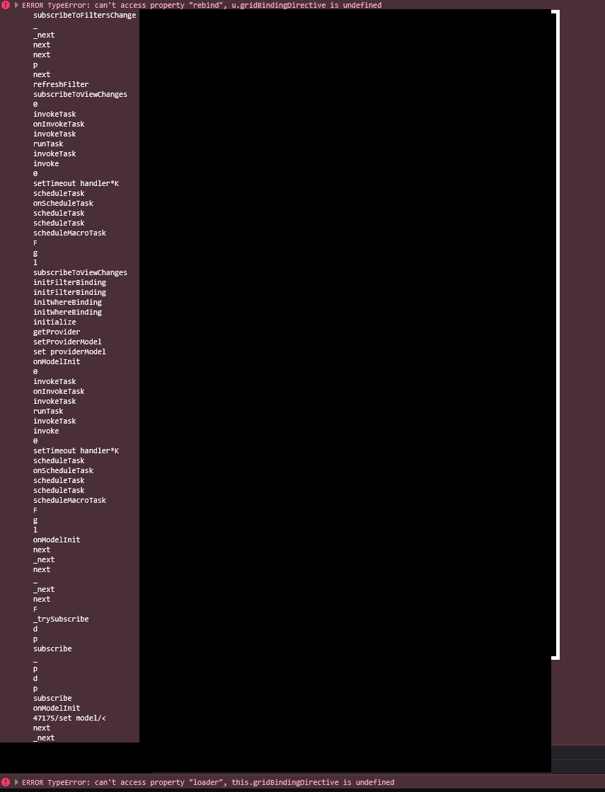

Hmm, actually, if you have a grouping added at the user level I do get these errors in the console. I wasn’t getting anything testing from application studio
