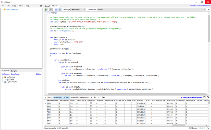

Screenshots

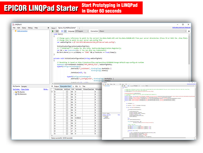

When Epicor 10.1.400 was released @Edge sent me his . linq files which required little to no configuration and it makes use of the web.config, reads the connection details and with it, allows you to use the ErpContext() or IceContext() - you know that fancy Db object in Method and Data Directives, yes that one. Thank’s Stephen!
Configuration

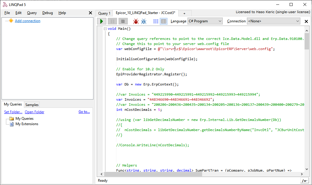

Once you download the Epicor_10_LINQPad_Starter.linq file and open it.

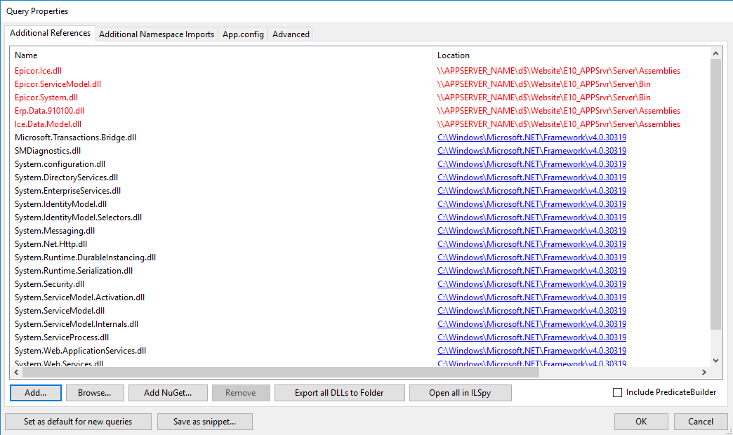

Press F4 it will bring up a dialog where you can point to your Server’s Assemblies. Fix the ones in RED, shown below are the typical 10.1.500.x paths for the Assembly Locations.

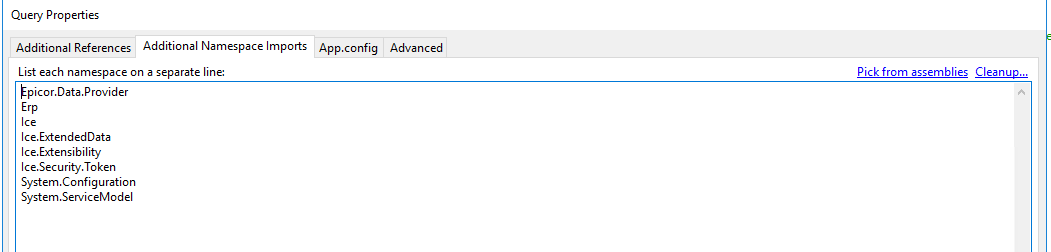

The Starter file includes common used Namespaces:

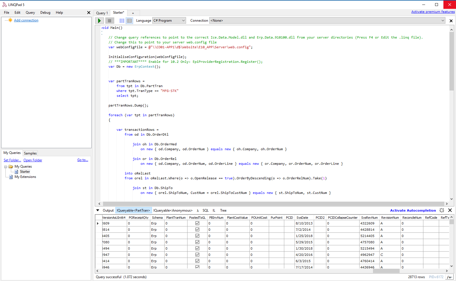

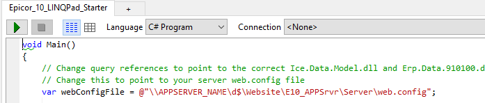

In the LINQPad Window point to your web.config file:
You should be all set, it was that easy. You don’t need a Connection! Remember it reads it from your web.config

  1. One limitation is that you can’t use ttTables, the idea is that you use this with actual tables such as Db.Part and prototype, debug and analyze your query. Once you are confident that it’s all good to go - you make some minor tweaks and paste it into a BPM.

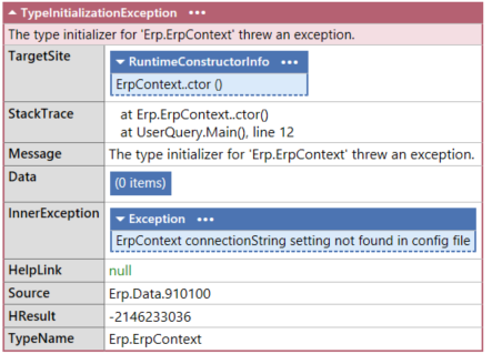

Hi All,
I keep getting this error.
TypeInitializationException: The type initializer for 'Erp.ErpContext' threw an exception.
I have read the other threads which state change the data source in the web.config file. I did this but no further forward.

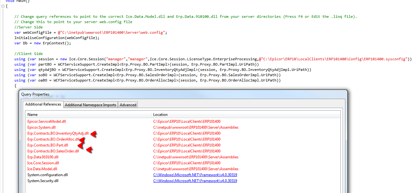

Not sure – my most recent one looks like this:
I had to add in a reference to EntityFramework to get it to work.

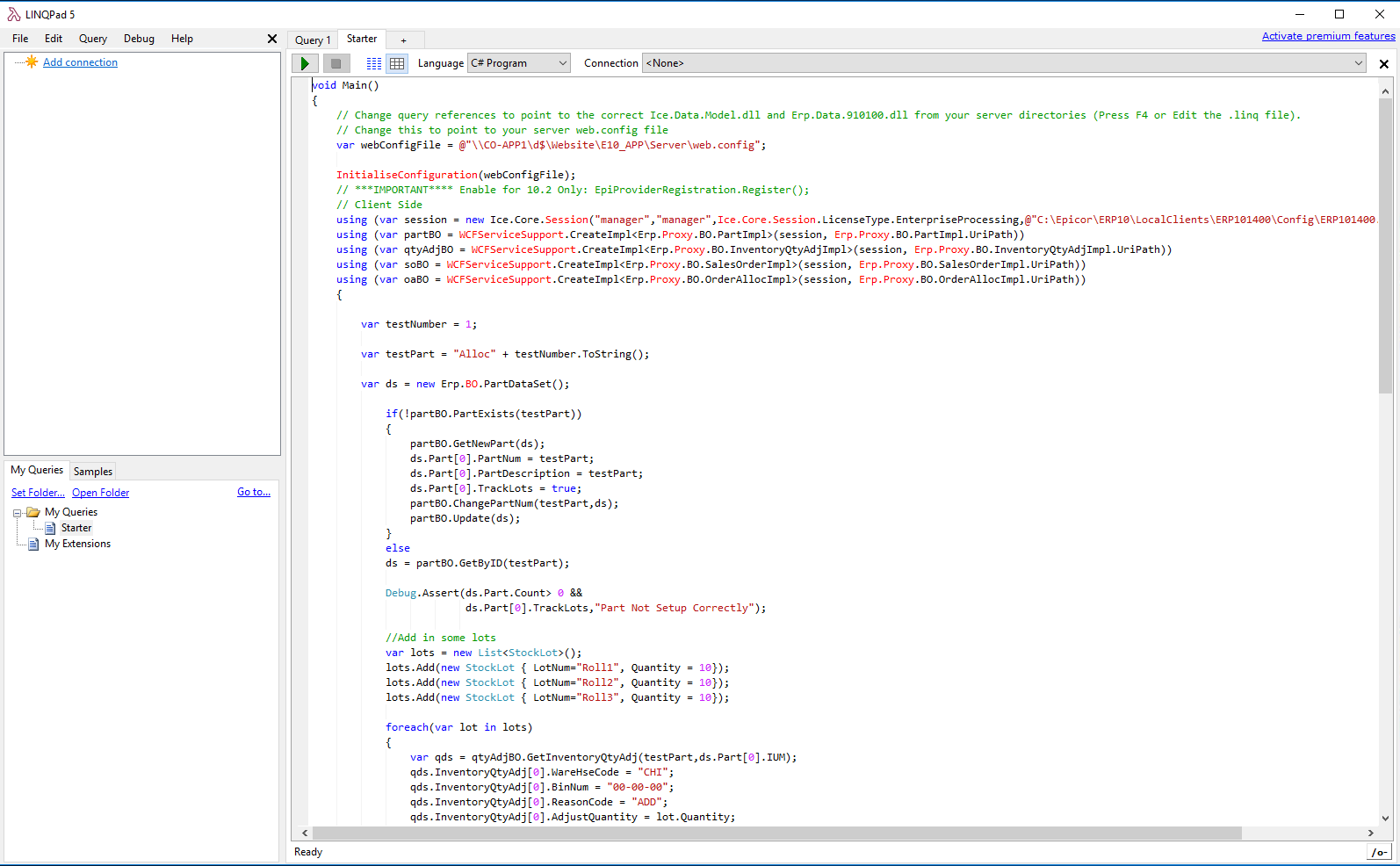

Getting error on this:
		   boPriceListInquiry = Ice.Assemblies.ServiceRenderer.GetService<Erp.Contracts.PriceListInquirySvcContract>(Db);
Value cannot be null.
Parameter name: Operation
Any ideas???

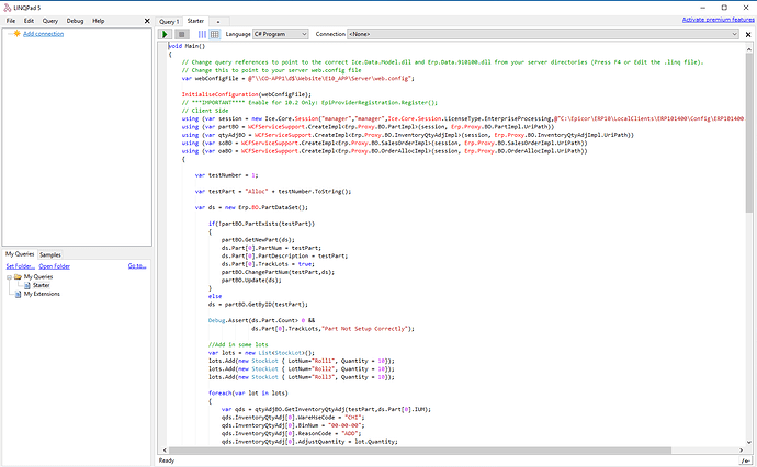

My above screenshot may be misleading as it shows me using something similar - I later replaced it.

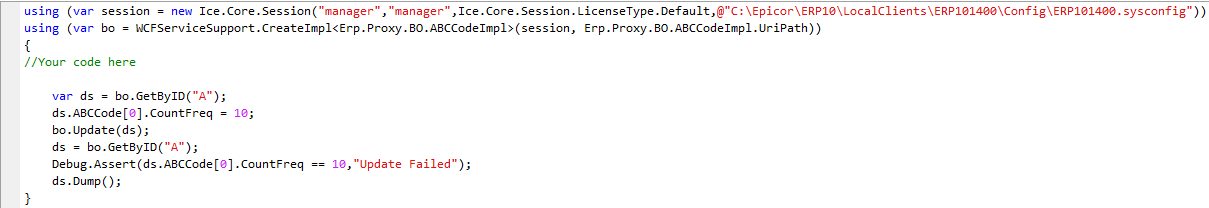

Since LINQPad is basically considered a “client” and you are not on the Server, you have to use WCFServiceSupport and first create a Session, the reason you get that weird error is probably because you dont have a valid session.
Also see the screenshot all the way-up (first one).

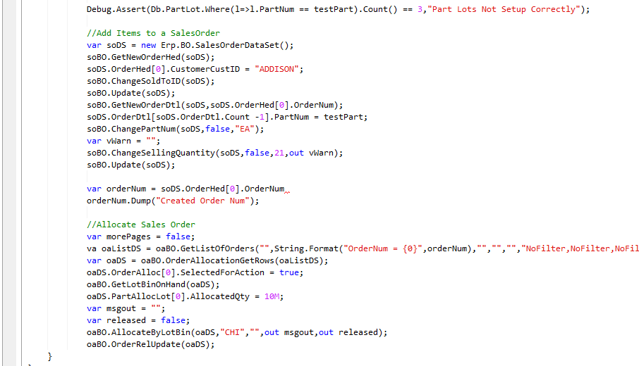

Solved this by using a different way to look at the data, but thank you! I did have a proper session setup thanks to your awesome example!
	// Client Init
	using (var session = new Ice.Core.Session("manager","manager",Ice.Core.Session.LicenseType.EnterpriseProcessing,@"D:\Epicor\ERP10\LocalClients\EpicorERPPilot\config\EpicorERPPilot.sysconfig"))
	using (var pli = WCFServiceSupport.CreateImpl<Erp.Proxy.BO.PriceListInquiryImpl>(session, Erp.Proxy.BO.PriceListInquiryImpl.UriPath))
