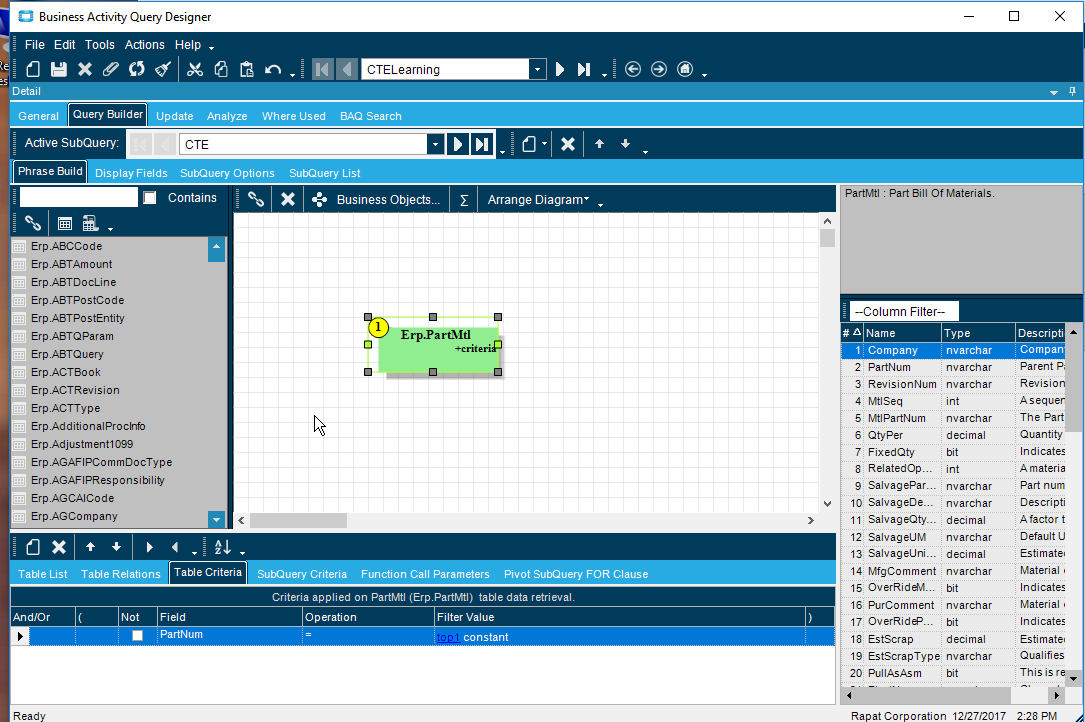

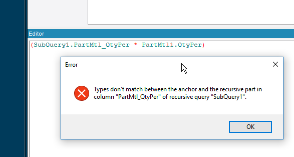

I’m having trouble trying to figure out how to get a total quantity on a CTE BOM query. Basically if there are 2 of part A, which goes into assembly B, and assembly B has a quantity 2 which goes into TopAssembly C, the total quantity of part A needs to be 4. What I have right now is just grabbing the quantity per and making a table, then grouping and summing in that table. That gets me close, but like in the situation listed above, won’t multiply like it should. I tried replacing the QtyPer with a calculated field that multiplies the lower level Qtyper by the next level up Qtyper, but I get an error when I try to do that. I can use one, or the other with no error, but when I try to multiply them, it pukes. I’m not any good at CTE queries, so I’m sure that I am doing something wrong, but I’m not sure where to go from here. Anyone have an example I can look at for this?

with [SubQuery1] as
(select
(PartMtl.PartNum) as [Calculated_IntialPart],
(Part1.PartDescription) as [Calculated_InitialPartDesc],
[PartMtl].[Company] as [PartMtl_Company],
[PartMtl].[PartNum] as [PartMtl_PartNum],
[PartMtl].[MtlPartNum] as [PartMtl_MtlPartNum],
[PartMtl].[QtyPer] as [PartMtl_QtyPer]
from Erp.PartMtl as PartMtl
inner join Erp.Part as Part1 on
PartMtl.Company = Part1.Company
and PartMtl.PartNum = Part1.PartNum
union all
select
(SubQuery1.Calculated_IntialPart) as [Calculated_intialpart2],
(SubQuery1.Calculated_InitialPartDesc) as [Calculated_InitialPartDesc2],
[PartMtl1].[Company] as [PartMtl1_Company],
[PartMtl1].[PartNum] as [PartMtl1_PartNum],
[PartMtl1].[MtlPartNum] as [PartMtl1_MtlPartNum],
[PartMtl1].[QtyPer] as [PartMtl1_QtyPer]
from Erp.PartMtl as PartMtl1
inner join SubQuery1 as SubQuery1 on
PartMtl1.Company = SubQuery1.PartMtl_Company
and PartMtl1.PartNum = SubQuery1.PartMtl_MtlPartNum)

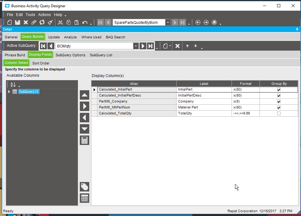

from (select
[SubQuery12].[Calculated_IntialPart] as [Calculated_IntialPart],
[SubQuery12].[Calculated_InitialPartDesc] as [Calculated_InitialPartDesc],
[SubQuery12].[PartMtl_Company] as [PartMtl_Company],
[SubQuery12].[PartMtl_MtlPartNum] as [PartMtl_MtlPartNum],
(sum( SubQuery12.PartMtl_QtyPer )) as [Calculated_TotalQty]
from SubQuery1 as SubQuery12
group by [SubQuery12].[Calculated_IntialPart],
[SubQuery12].[Calculated_InitialPartDesc],
[SubQuery12].[PartMtl_Company],
[SubQuery12].[PartMtl_MtlPartNum]) as BOMqty
