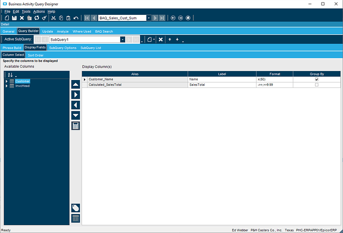

I’m trying to create a BAQ that will give me YTD customer sales by customer name. I am stumped however currently. I created it using ERP.Customer and ERP.InvHead. Then I created table criteria based upon parameter for start and end dates which must be input upon running it. For the display fields, I have Customer_Name of which I selected for Group By, then I created a calculated field
Yet I get the error message
"Column “ERP.InvcHead.InvoiceAmt” is invalid in the select list because it is not contained in either an aggregate function or the Group BY clause.
If I click the group by for the calculated field, nothing works.
If I remove the group by for the Customer Name, it works, but will basically total the YTD on each invoice, creating multiple customer lines with the same YTD total. How do I fix this?
When using a Windowing function you probably don’t need any Group By’s.
If you want the YTD total per customer, you can’t have the Invoice Number in the select list.
Can you provide a screenshot of the fields you have selected to Display?
Just have the customer name and the calculated field
If I remove the group by, then it ends up looking like this:
Remove the “Over (Partition By…” in the calculated field so that it just reads “Sum(InvcHead.InvoiceAmt)”
You then want to mark the Customer.Name field as Group By. You should only use either the window function or the group by on another field.

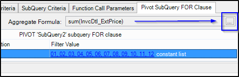

Right click on Sub Query 2 and set Pivot
Set the Pivot field to InvMonth
Add Months 01 thru 12 (Need to have the leading 0)
Set your Aggregate Formula to InvDtl_ExtPrice
