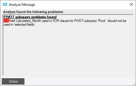

Okay, so now the problem. When I try to save or test the query I get this error:
Here’s the BAQ Phrase:

Even though I get an error it still runs and will give me the correct data when I test it, which is super frustrating… It’s my first BAQ with a Pivot so I appreciate any help.
