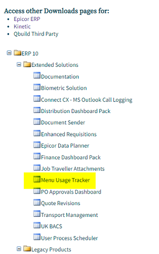

Menu Item usage per user
We purchased the following add on from Epicor when we were on Epicor 10 and it is still working on Kinetic
It only tells you what screens were accessed rather than specific method calls.
