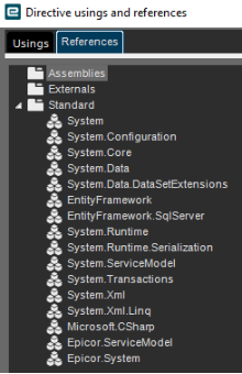

We have this exact code working elsewhere in our system. But, I cannot create new bpms using this same code nor can I edit the existing ones as they will start posting this same error. I also see that System.Transactions is listed in the references section by default shown in the screen shot below:
Why would I be receiving this error now?

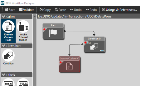

Steps to Recreate Error:
  1. Load at least one row into the UD01 table
  2. Create a In-Transaction Data Directive for UD01
  3. Create the following in designer
  1. Create the following condition
  1. Paste the following into the custom code block
  2. using (var txScope = IceContext.CreateDefaultTransactionScope())
    foreach(var UD01 in (from row in Db.UD01 select row))
    Db.UD01.Delete(UD01);
    Db.Validate();
    txScope.Complete();
7. Check the syntax in the custom block and you should get the same error.
If you save and activate this bpm it’ll error the first time it runs then refuse to operate after.
The use case for this is to allow end users to delete items out of a UD table as needed.

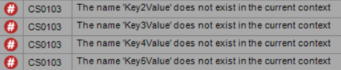

When trying to run the code you supplied in either a data directive or method directive I get errors for the keys:
I also tried using dsUD05Row.Key2 as context with the same result. Any idea what I can do to fix this?

The “KeyXValue” references are placeholders. You have to change those to whatever references you are using in your BPM.
