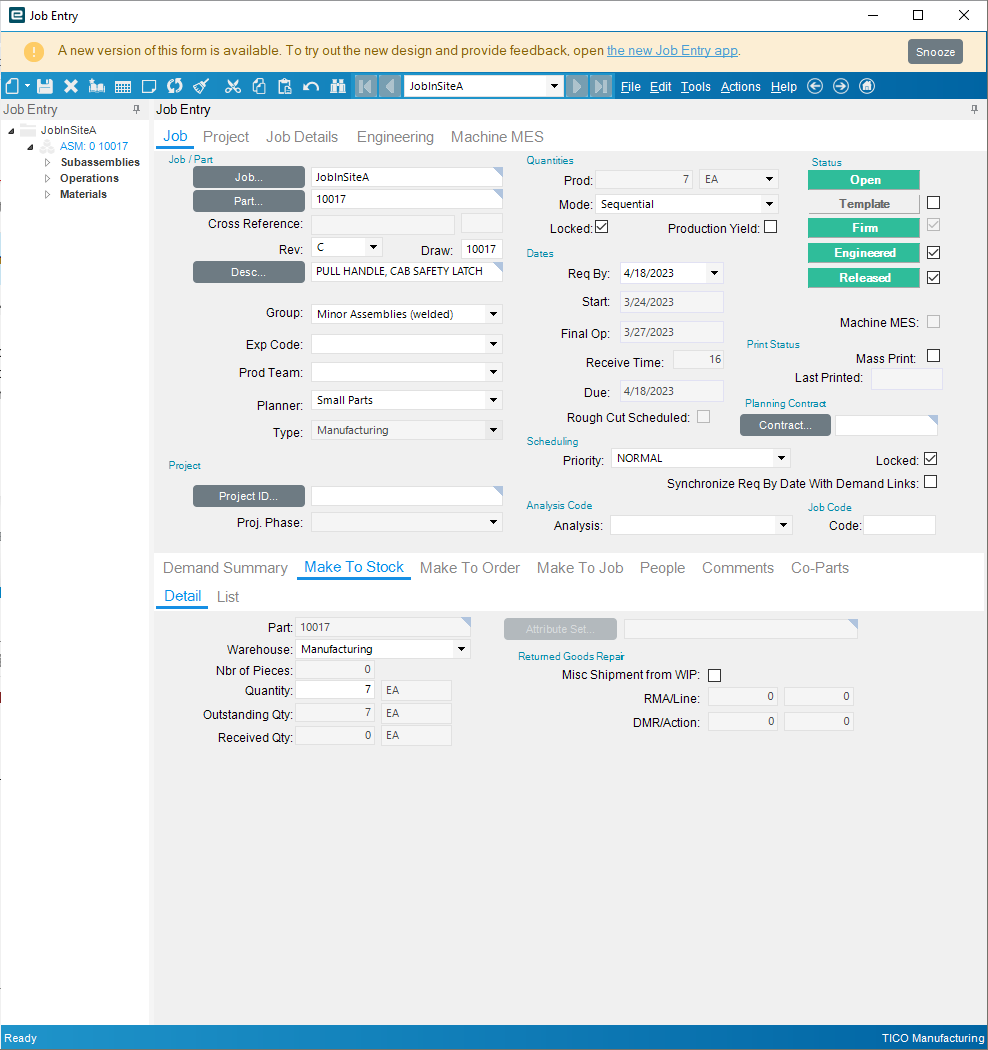

The screen is Job Receipt to Job. You just specify a job in the other site.
I did the job in site A as make to stock. I am not saying that it is right; I just did. I’ll explain later.

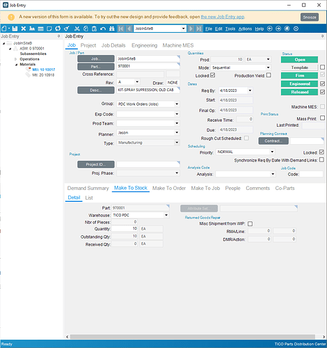

Job in site B is similar:
Here is the transaction in site A (MFG-PLT):
(Ignore the 2 auto-receipts of +7 and -7. I forgot to uncheck auto-receive in this job - which is kind of a good point…)

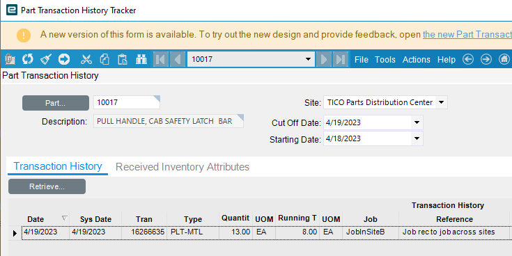

And in site B… nothing… yet.
I have to do a Transfer Order Receipt in order for that to go through.
That’s better:
