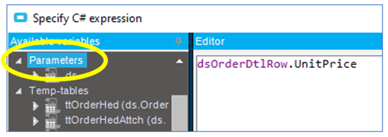

I created a variable, OldUnitPrice, to hold the “before” value and then tried to compare it to the “after” value. The displays a message based on the comparison and the message contains both the variable value and the ttUnitPrice value
Create variable and set equal to parameter.
Evaluate this condition
Results
The variable does not appear to capture the “before” value. None of the tests resulted in the “value has changed.”
