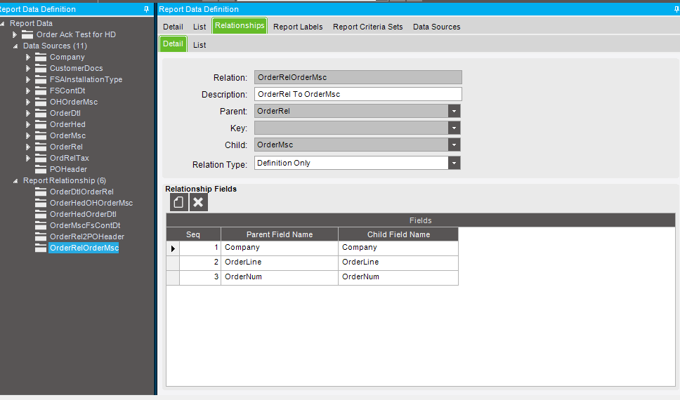

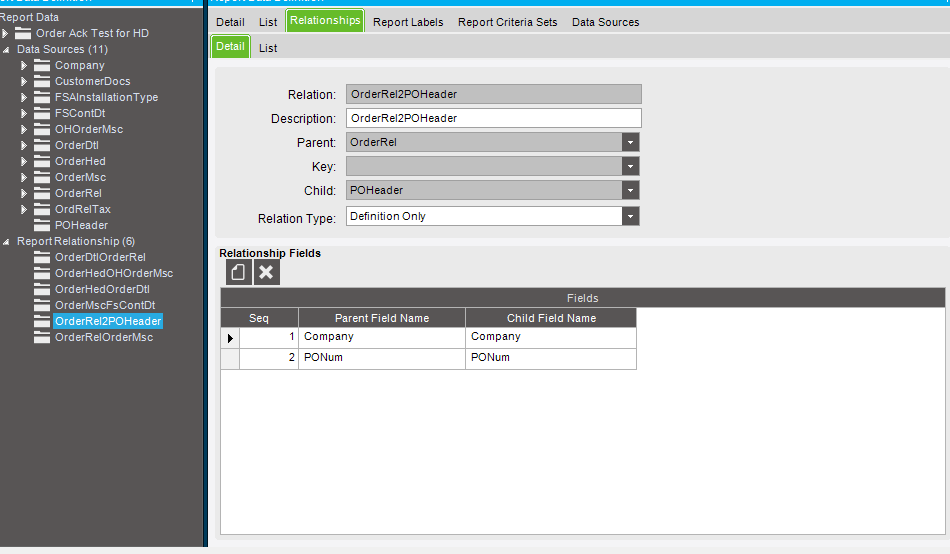

Also your screenshot is not of your relationship that you made to POHeader.
Sorry put wrong relationship. Here is the correct one.

Attached the correct Picture.
I personally have tried to unravel that mess manually. Save yourself the time and recreate. It may be fixed in newer versions, but historically its never worked well.

Also, using a relationship of “Definition” will limit the original records to only those that have a matching POHeader record. So none of the lines for Stock items would show up.
Agree. I have had some weirdness with Definition only. I use Output across the board for all joins, and change the join type in the SQL query inside the SSRS report. I feel like most of my past issues were with weird temp datasets that aren’t actually tables.

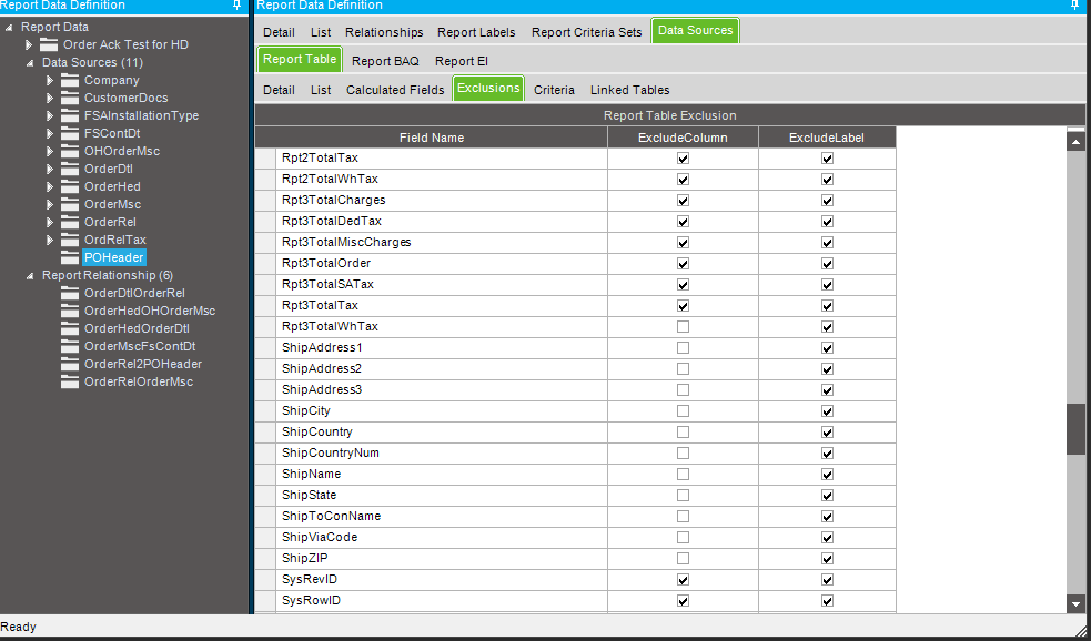

And another gotcha that will affect you at the RDD level, is excluding fields in the added table that are used in the joins.
A quick test that the RDD “works” (menaing doesn’t generate runtime errors, as opposed to not giving you the output you desire), is to make the changes to the RDD, duplicate the report style and update its DataDef value to the new RDD. Make no changes to the new RDL. The report should run identical to the source you copied it from. If you get any erros, they are in the RDD.

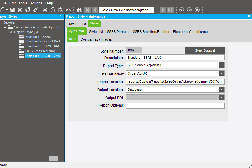

3)Next I opened the original SOForm and resaved it as SOFormBOL n the Custom Reports folder.
4)On the report style I pointed to my new data definition with the added tables and on the Report Location I changed the name to SOFormBOL. I DID NOT CLICK ON SYNC DATASET.
5) Ran a trial Print without changing anything and it came up just like the original.

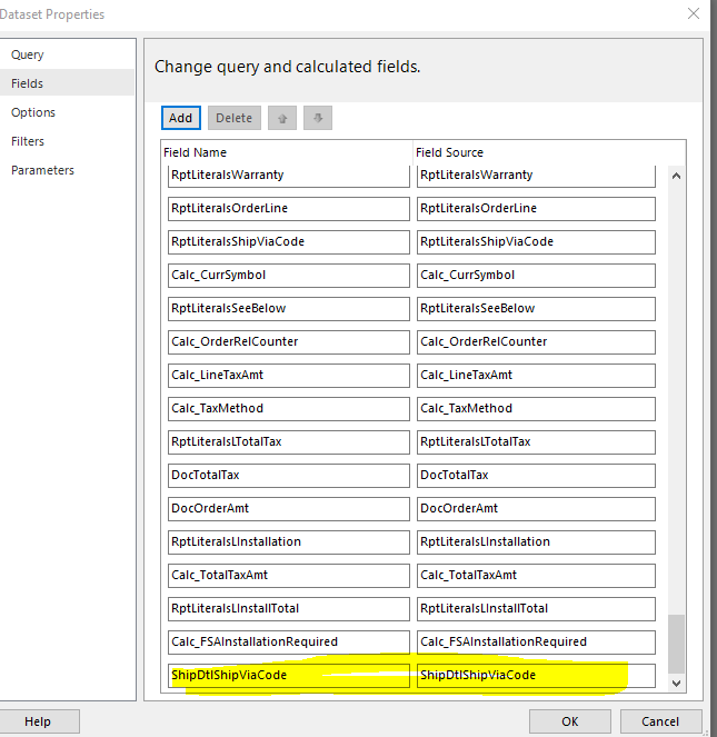

The step the evil button tried to automate, was the step of going into your SSRS report dataset and adding the link/fields into the query. You can manually add this by finding your main dataset. Usually named something similar to the reportstyle. Right Click > Properties. Find the formula expression button for the query and manually add the link/fields in
SELECT T2.YourNewFieldHere FROM OrderRel_" + Parameters!TableGuid.Value + " T1 INNER JOIN POHeader_" + Parameters!TableGuid.Value + " ON T1.Company = T2.Company AND T1.PONum = T2.PONum
Alright so I went to OrderHed and modified the Expression to the following
=“SELECT T1.RptLanguageID,T1.CardNumber,T1.NeedByDate,T1.OrderComment,T1.OrderDate,T1.OrderNum,T1.PONum,T1.Calc_BillToAddressList,T1.Calc_BillToContact,T1.Calc_CardNumber,T1.Calc_CustPartOpts,T1.Calc_FobDesc,T1.Calc_MultiNeedDate,T1.Calc_MultiRef,T1.Calc_MultiShipContacts,T1.Calc_MultiShipTo,T1.Calc_MultiShipVia,T1.Calc_PrcEmail,T1.Calc_PrcFax,T1.Calc_PrcPhone,T1.Calc_SalesPerson,T1.Calc_ShipToAddressList,T1.Calc_ShipToContact,T1.Calc_ShipToEmail,T1.Calc_ShipToFax,T1.Calc_ShipToPhone,T1.Calc_ShipViaDesc,T1.Calc_TermsDesc,T1.CurrencyCode_CurrDesc,T1.CurrencyCode_CurrSymbol,T1.Customer_ResaleID, T1.Calc_CurrSymbol, T1.Calc_MiscTotal, T1.Calc_LineMiscTotal,T2.Company,T2.ContractNum,T2.DisplaySeq,T2.DocDiscount,T2.DocUnitPrice,T2.KitFlag,T2.KitPricing,T2.KitPrintCompsInv,T2.KitShipComplete,T2.OrderComment AS OrderDtl_OrderComment,T2.OrderLine,T2.PartNum,T2.POLine,T2.PricePerCode,T2.Reference,T2.RevisionNum,T2.SalesUM,T2.SellingQuantity,T2.WarrantyComment,T2.XPartNum,T2.XRevisionNum,T2.Calc_ExtPrice,T2.Calc_LineDesc,T2.PartNum_PartDescription,T2.WarrantyCode_WarrDescription,T2.Calc_UOMForeignDesc, T2.Calc_FSAInstallationDesc, T2.Calc_FSAInstallationType, T2.Calc_FSAInstallPrice,T2.Calc_LineTaxAmt,T2.Calc_FSAInstallationRequired, T3.NeedByDate AS OrderRel_NeedByDate,T3.OrderRelNum,T3.Reference AS OrderRel_Reference,T3.ReqDate,T3.SellingReqQty,T3.ShipViaCode,T3.Calc_ResaleID,T3.Calc_ShipToAddressList AS OrderRel_Calc_ShipToAddressList,T3.Calc_ShipToContact AS OrderRel_Calc_ShipToContact,T3.ShipViaCode_Description,T3.Calc_OrderRelCounter,T4.Calc_ExtPrice AS RptLiteralsCalc_ExtPrice,T4.Calc_OrderTotal AS RptLiteralsCalc_OrderTotal,T4.Calc_SalesPerson AS RptLiteralsCalc_SalesPerson,T4.Calc_ShipToContact AS RptLiteralsCalc_ShipToContact,T4.RptLiteralsDiscount,T4.FaxNum AS RptLiteralsFaxNum,T4.FOB AS RptLiteralsFOB,T4.NeedByDate AS RptLiteralsNeedByDate,T4.OrderDate AS RptLiteralsOrderDate,T4.RptLiteralsLLine,T4.OrderQty AS RptLiteralsOrderQty,T4.OrderRelNum AS RptLiteralsOrderRelNum,T4.PhoneNum AS RptLiteralsPhoneNum,T4.Reference AS RptLiteralsReference,T4.ResaleID AS RptLiteralsResaleID,T4.RevisionNum AS RptLiteralsRevisionNum,T4.RptLiteralsLCrdNum,T4.RptLiteralsLCustPart,T4.RptLiteralsLDate,T4.RptLiteralsLEmail,T4.RptLiteralsLFax,T4.RptLiteralsLPhone,T4.RptLiteralsLLNMSC,T4.RptLiteralsLOrderAck,T4.RptLiteralsLORMSC,T4.RptLiteralsLORNUM,T4.RptLiteralsLOurPart,T4.RptLiteralsLPage,T4.RptLiteralsLPONum,T4.RptLiteralsLPriPer,T4.RptLiteralsLPrtDes,T4.RptLiteralsLQty,T4.RptLiteralsLShipTo,T4.RptLiteralsLSHSHC,T4.RptLiteralsLSHSHM,T4.RptLiteralsLSLSHE,T4.RptLiteralsLSoldTo,T4.RptLiteralsLSubTotal,T4.RptLiteralsLTerms,T4.RptLiteralsLYURPOLN,T4.RptLiteralsSalesKit,T4.UnitPrice AS RptLiteralsUnitPrice,T4.Warranty AS RptLiteralsWarranty,T4.ShipViaCode AS RptLiteralsShipViaCode,T4.OrderLine AS RptLiteralsOrderLine, T4.RptLiteralsSeeBelow, T1.Calc_TaxMethod, T4.RptLiteralsLTotalTax, T1.DocTotalTax, T1.DocOrderAmt, T1.Calc_TotalTaxAmt, T4.RptLiteralsLInstallation, T4.RptLiteralsLInstallTotal, T5.ShipViaCode as ShipDtlShipViaCode
FROM OrderHed_” + Parameters!TableGuid.Value + " T1
LEFT OUTER JOIN OrderDtl_" + Parameters!TableGuid.Value + " T2
ON T1.Company = T2.Company AND T1.OrderNum = T2.OrderNum
LEFT OUTER JOIN OrderRel_" + Parameters!TableGuid.Value + " T3
ON T2.Company = T3.Company AND T2.OrderNum = T3.OrderNum AND T2.OrderLine = T3.OrderLine
LEFT OUTER JOIN RptLabels_" + Parameters!TableGuid.Value + " T4
ON T1.RptLanguageID = T4.RptLanguageID LEFT OUTER JOIN POHeader_" + Parameters!TableGuid.Value + " T5 ON T3.Company = T5.CompanyAND T3.PONum = T5.PONum AND T3.OrderNum = T5.OrderNum"
The Bold is what I added. Then added it to the fields as a query field. Picture below
