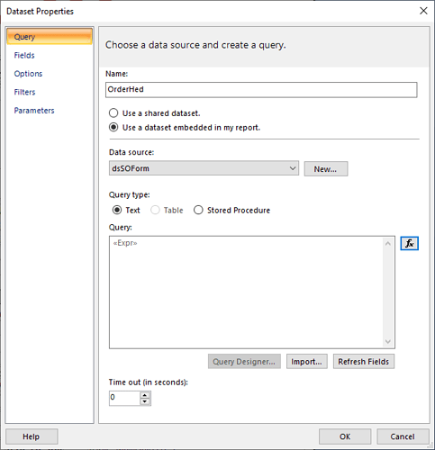

If I go to Report Builder Designer and modify the query for the dataset, it appears to be pulling data from the temp tables. If I cannot get the second relationship into the temp tables, how can I modify the query to pull this information?

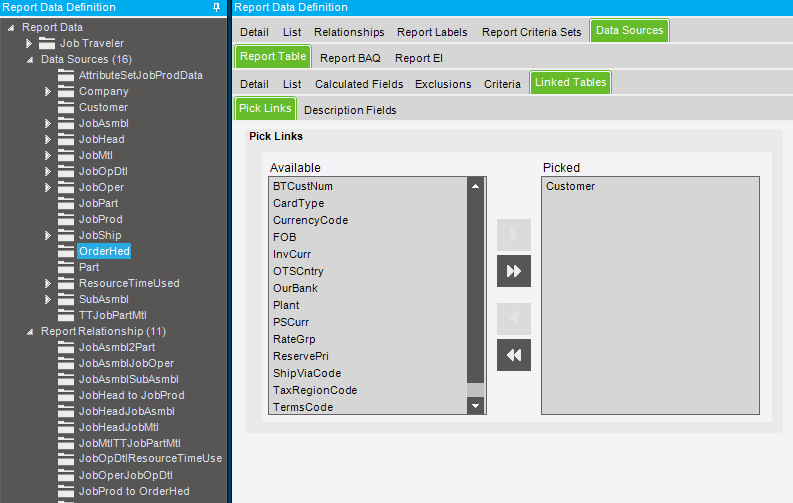

Epicor builds extra relationships that you can add in as needed. You move a table from Available to Picked and then you can select the fields you want on the second tab. You don’t need to build the relationship as Epicor has already done it in the background.

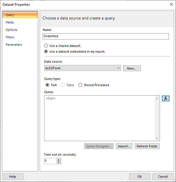

Once the tables have been created in the DB, the SSRS Dataset Query takes over. At this point it is just SQL in the query. You can use any SQL tricks you know. One of my favorites is using CTEs in the Dataset Query.
At this point, you have your Tables being output to the SQL DB and the SSRS report querying those tables to create the dataset.

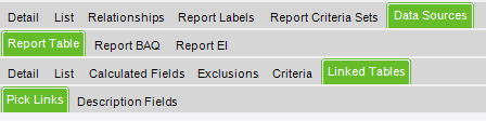

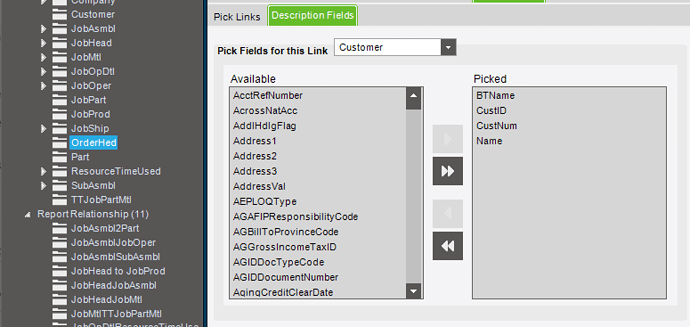

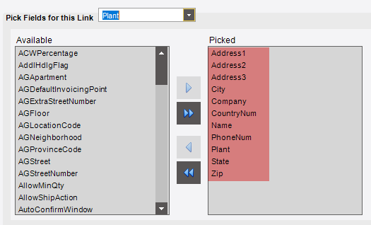

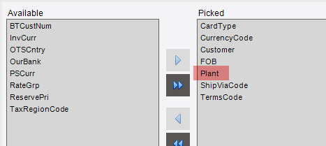

Now, if you want to use data from a Linked Table, you first need to copy the System RDD and create your own as you cannot modify the system ones. Select the Table that you want to use the Linked Data on, in my case it is OrderHed. Go to the Linked Tables tab and make sure the table you want is in the Picked list. Then go to the Description tab and select the fields from the table that you want.

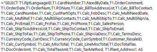

Now, to get the field in the report Dataset, they get added as a field on the table that you are hanging off of. In my example I used the Plant table off of the OrderHed table. In my Dataset Query, OrderHed is T1 so I need to add the field T1.Plant_Address1 to the statement. You also need to add the field to the list of fields in the Dataset.

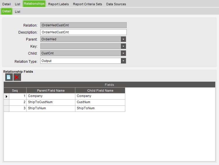

If you need a new table, you add it in your RDD and expose the fields you need for the report and the fields you need to create a relationship on. In my example, I added CustCnt to my RDD and created the relationship to OrderHed. Note: always leave Key field blank and make sure the Relation Type field is Output.

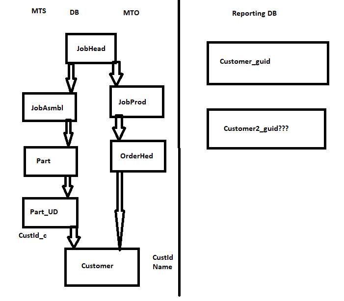

In our situation we have 2 paths to get to the Customer Name and CustID, which we want to print on the Job Traveler. Since we manufacturer parts specific to customers, we’ve added a ud field to the part table for custid (PartNum_CustId_c - I do not know why they didn’t use custnum - before my time). If the part is make to stock or just make to job, we want the part customer on the report.
If the job is a make to order, then we want the customer the order is for to be listed.
I understand the process of pulling from the db and creating the guid temp tables in the reporting db, but I have no idea how it would handle the multi path to the customer table. Would it create just one Customer_guid table or would it create a customer and a customer2 table based on path. At this time, based on your feedback, it appears to be just one table Customer_guid. If I had access to the schema it would answer this question. Then the next question is it adding both paths worth of information. Really wished I could dump the table somehow to see.
As of right now, MTS & MTJ’s are correctly being produced - as they were before I headed down this path. MTO’s are still not showing any customer information. If I could see the OrderHed_guid table I’d know if it was at least getting the ordernum.

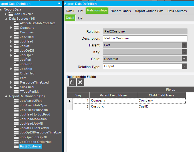

Here is the defined relationship to the Customer table:

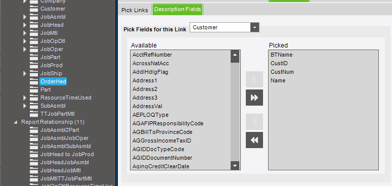

Here is the linked table to the Customer table:
And here are the fields from the linked table:
