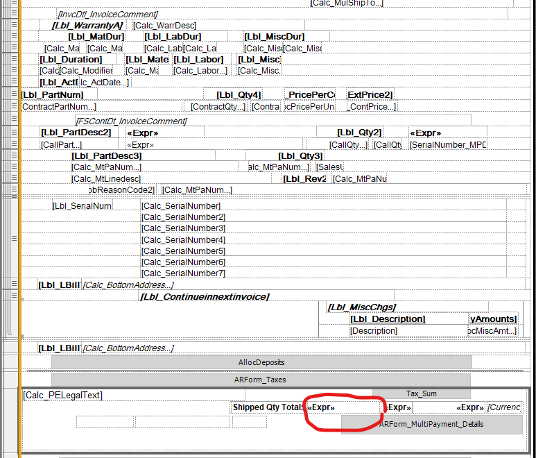

Is your SUM supposed to be line based or are you trying to get the number of pieces shipped for the whole invoice?
Whole Invoice.
The textbox that displays it is not in the lines part of the report. It is below, if that makes sense.
There is a screenshot above circling where the textbox is, if that helps (I think post #7?)
Did you make any changes to the RDD or to the Query in the RDL?
You have to be more specific.
This report has been heavily modified for years.
Recently, I added the expression from a few posts up to see if that helped.
I can try copying the base report and making the one change from above to it to see if that also does it.
I will post back after I try that.
