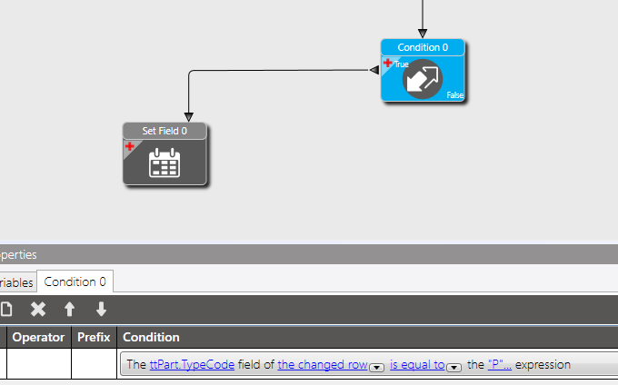

So its been requested to have all added Purchased parts to default to require inspection. I got a BPM to work great for the Part table. This is what i have set.

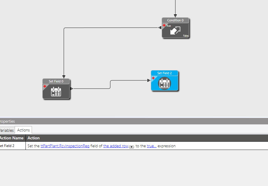

But I add another Set Field to set PartPlant.RcvInspectionReq. Like this:
When the Part is being added, the PartPlant record won’t exist. You should be able to get away with a Data Directive on the PartPlant table. However, if you are sticking with Method Directive, you will need to:
Pre-Processing to enable a Post-Processing when a new record and purchased
Post-Processing to update the PartPlant record and save.
