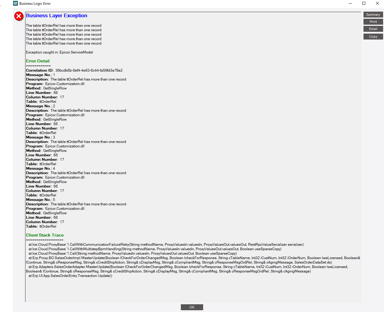

I have taken over looking after Epicor, and I have inherited an issue that users are experiencing - when they convert a quote to an order, or when they amend details on an order, say ship by or need by dates, they are getting the below error:
From looking at similar issues that have been posted here, it seems this has something to do with BPMs potentially but I’m a total novice with these. We currently have 4 BPMs for this:
1 standard, which is to email when a customer line release is updated,
3 in-transaction: Unconfirm release (checks for added rows to OrderRel table and "Set the ttOrderRel.FirmRelease field of the changed row to the false… expression); SetOrderRelPlant (checks for <There is at least one added row in the ttOrderRel table and Number of rows in the MyQuery query is more or equal to 1>, then “Set the ttOrderRel.Plant field of the changed row to the callContextClient.CurrentPlant expression”); ChangeLog (if there is at least one updated row in the ttOrderRel table then “Log changes to the selected fields of ttOrderRel table”).
Any ideas on whether any of these BPMs might be the culprits and why? Thank you in advance!
