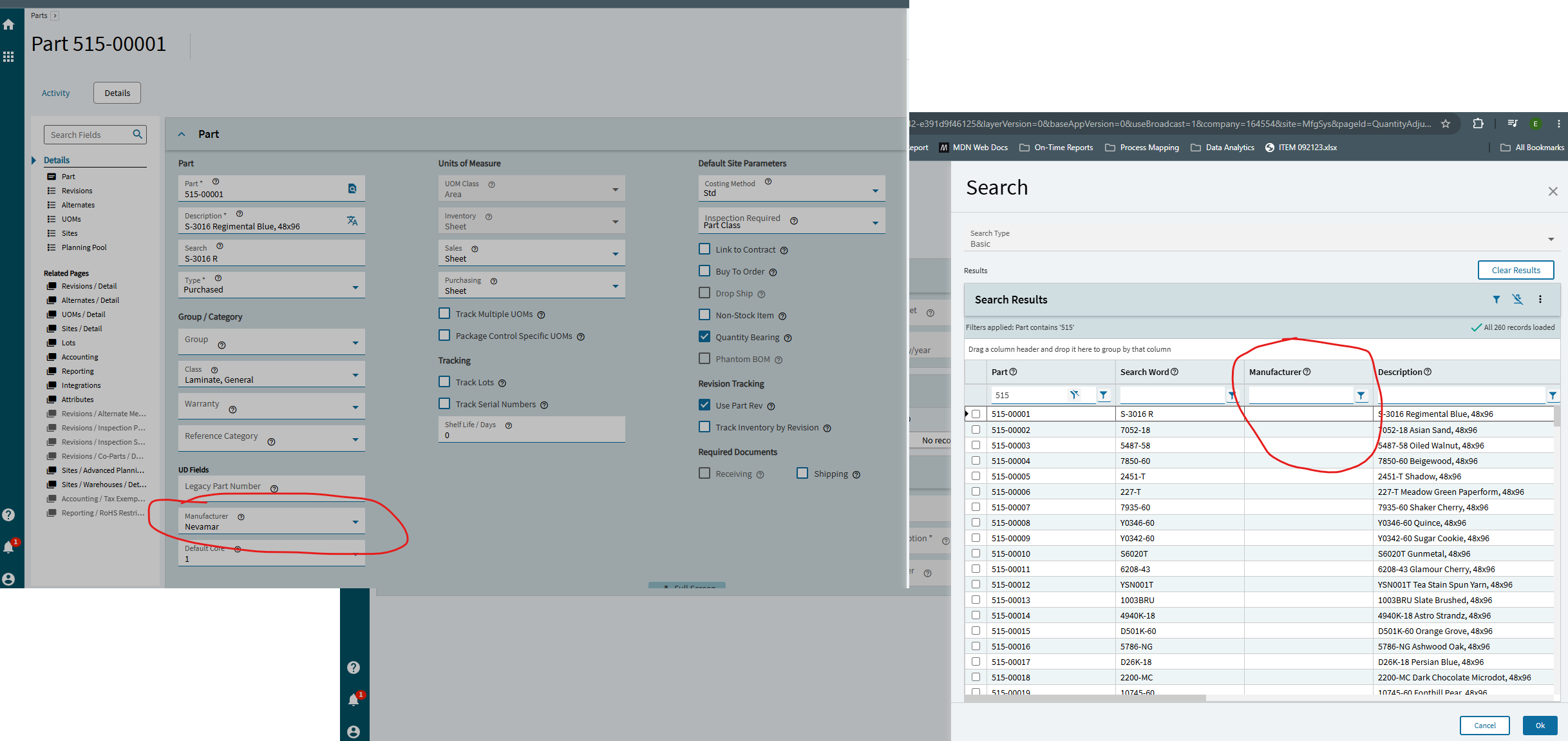

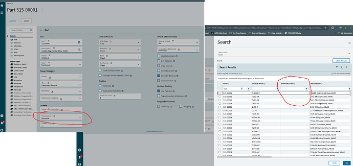

Now they are wanting to have the end user do a Quantity Adjust in Epicor when they want to sign out materials. We use a few UD columns in our Part setup to help identify parts, specifically with Laminates as we allow our customers to select from a vast catalog of options. We categorize them by “Manufacturer”, so we use a UD column for that data. However now when we access the Part Search the UD column is blank, even when the actual field is populated.
The “basic” search is pulling a specific predefined set of columns… UD columns aren’t going to be included. You’ll probably need to build a quick search or BAQ search for the data to get pulled in.

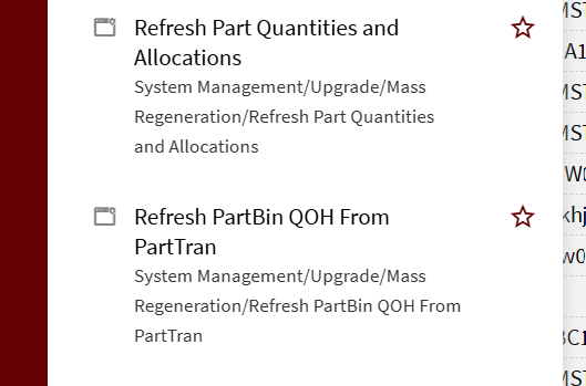

Make sure you regularly run the Refresh Part Quantities and Refresh PartBin processes if you’re doing this. I can tell you from experience that if you are doing lots of adjustments, the PartWhse records get thrown off really quickly. I would suggest daily.
