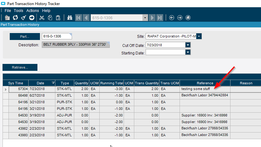

You could hijack the reference field, what’s your use case?
