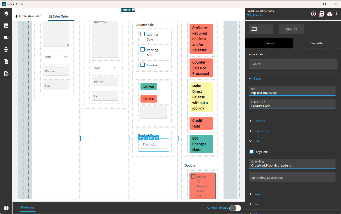

Has anyone had this issue? I created a UD field for the OrderHed table, regenerated the data model the field shows up in App Studio, I place the new field on the OrderHed form. All looks great, I have the field on the form, it can be typed in and looks/as normal. I have a BPM the checks to make sure the field isn’t empty (Make it required) that works well, the issue is this, I put data into the custom field, save the record and if I do a refresh the data is gone as in not saved? WTH, If I save and go to another record and return to the record I just updated the field is still blank. It’s hard to believe that native functionality doesn’t automatically handle the save? Is there something else I’m missing? Any insight would be appreciated. Thank you. FYI, It acts the same if I use orderhed.userchar1 as well, so I’m stumped?
Did you bind the field?
And specifically to the existing DataView that the update is working against.
Field has been bound to OrderHed.Prod_Grp_code_c

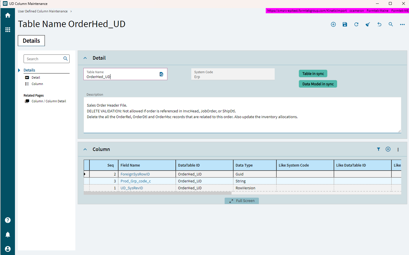

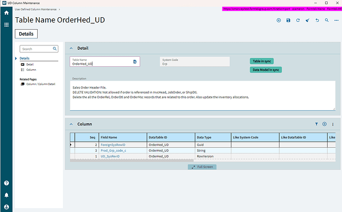

If you look in UD Column Maintenance, does it show your table is in sync?
Yes to the recycle…

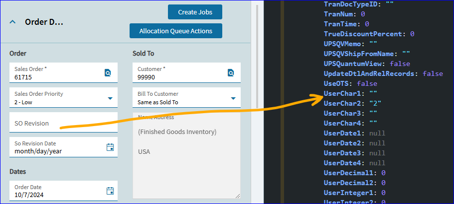

Before: No data entered (looking at the OrderHed dataview in debugger):

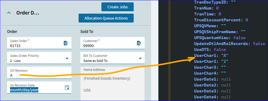

After entering a value and tabbing out: recheck dataview… I can see the updated value.
