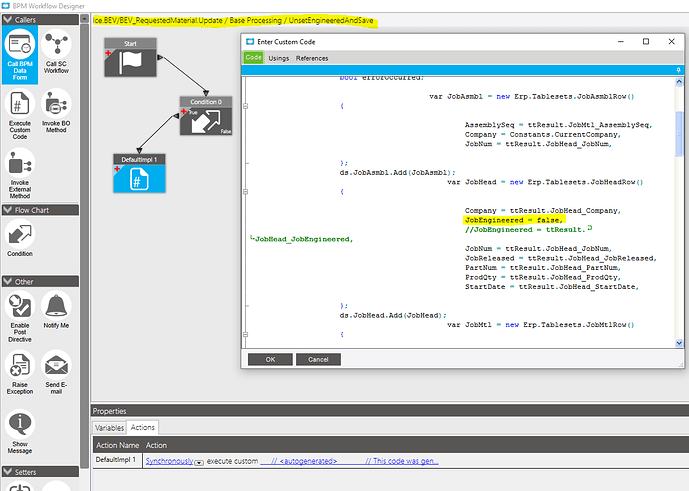

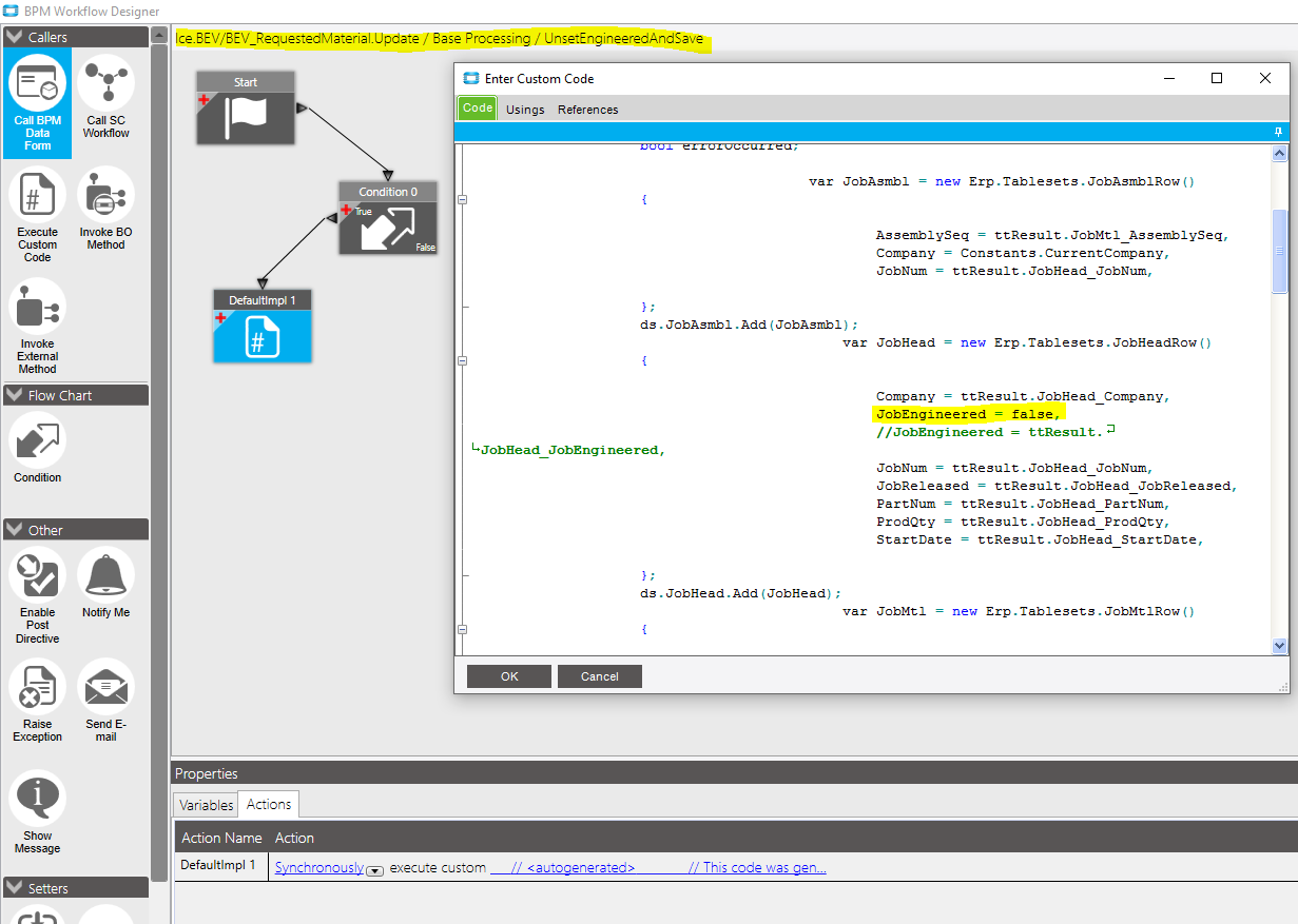

yes, use one of UD table to create record for each job Oper record at added status, use UD Key Company, Job Num and OpSeq,OpID then make one or more of non key fields updatable, (up to you) then link it to the JobOper table via these keys in your UpBAQ/UpDashboard, thereby you do not need to UnEngineer/UnRelease your jobs to update JobOper Record, alternatively, you can alter the updatable BAQ BPM to bypass the engineering flag to do this JobOper update then engineer/release back.
