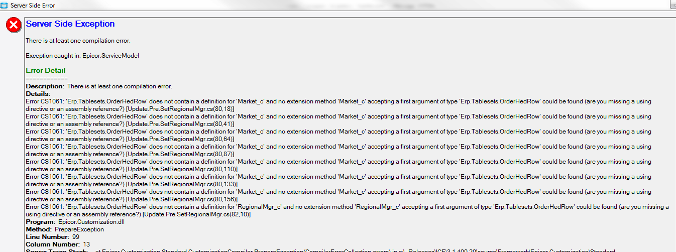

when i use logic with any UDField in a custome code BPM epicor didnt recognize the UDFields as part of the table please look below and advise

Ashley,
When using UD fields in C#, place the field name in quotes and brackets (no decimal after the table name).
ord[“Market_c”]
the solution is use
Table.UDField(“UDField”) to get the value of the UDField
Table.SetUDField(“UDField”,“Value”) to set the value of the UDField
