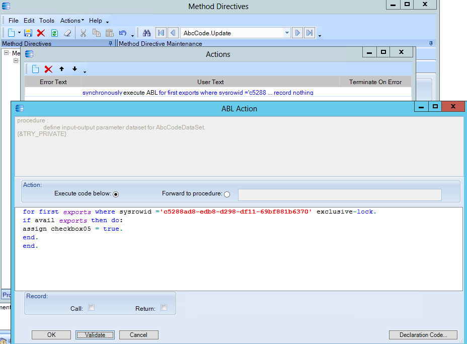

I used ABCCode.Update as the method in my example, but, it doesn’t really matter which one is used if you plan on changing the UD value after the record is created. In my example I used sysrowid as part of the where clause to make sure I only updated one record - but that could be anything as well (probably exportid).
for first exports where sysrowid =‘c5288ad8-edb8-d298-df11-69bf881b6370’ exclusive-lock.
if avail exports then do:
assign checkbox05 = true.
end.
end.
Thank you VERY much! Once I used “for first” instead of “find first” and “exclusive-lock” instead of “no-lock” I was able to update the dang checkbox. :blush: (Brain cramp…I’d been staring at it way too long!) I’m going to have a much better weekend without any “What if I did this…” thoughts running thru my head.
