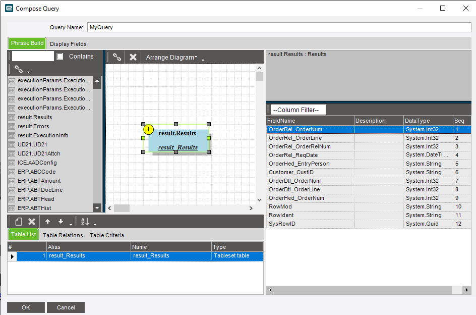

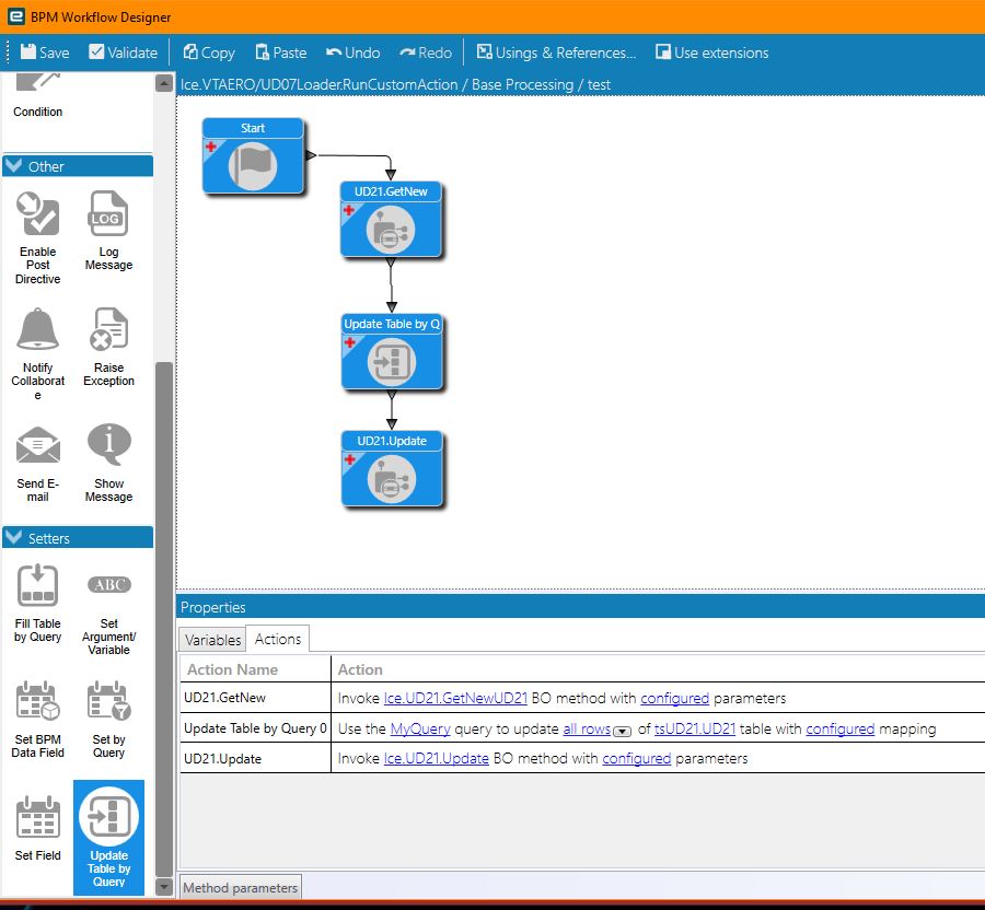

here is how I set it up:
the query
the mapping
You are almost there! Just add in the .Update widget for the UD table you are workign on. Put it after the update table by query. You may also need a GetDatasetForTree to create the dataset ahead of the update table by query.

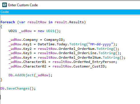

btw I did get it to work with this custom code, but still would like to understand the non code approach

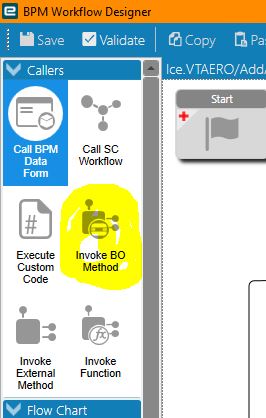

In the BPM, add an “Invoke BO Method Widget”:
Capture389891991

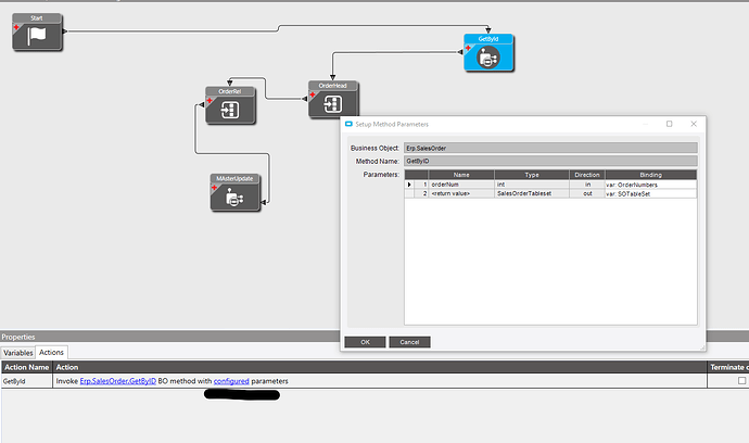

For the “specified” BO, choose SystemCode: ICE, Type: Business Object, ServiceName: UD21. Click Search and use the Update method. This method requires a tableset parameter. You create that first before you Update Table by Query. Copy your Update widget and change the BO method to Ice.UD21.GetByID. Assign the results of this to a tableset variable, then refer to the same variable in the update widget.

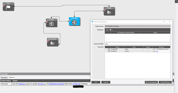

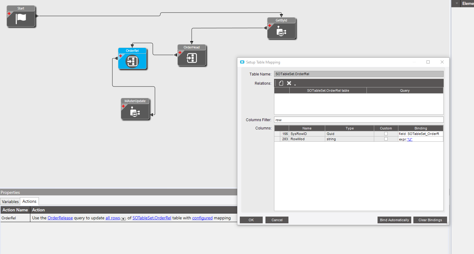

Set the RowMod to “A” for adding new records. “U” for updating.
I’m not seeing where to set the row mod in any of those 3 widgets.

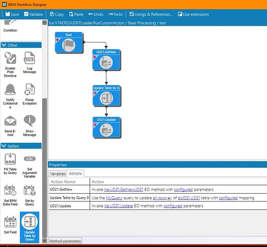

I did setup my bpm same as shown in @NateS screen shot,
when I execute my query, I get a single record (the first one) put in the table

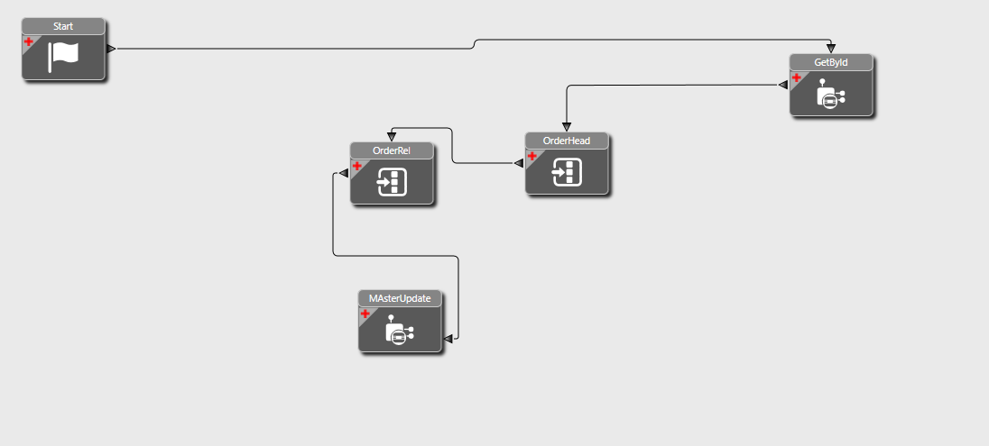

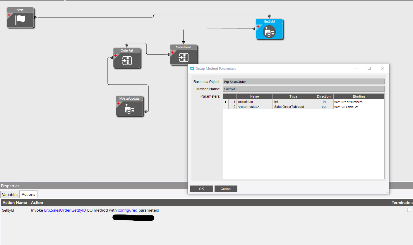

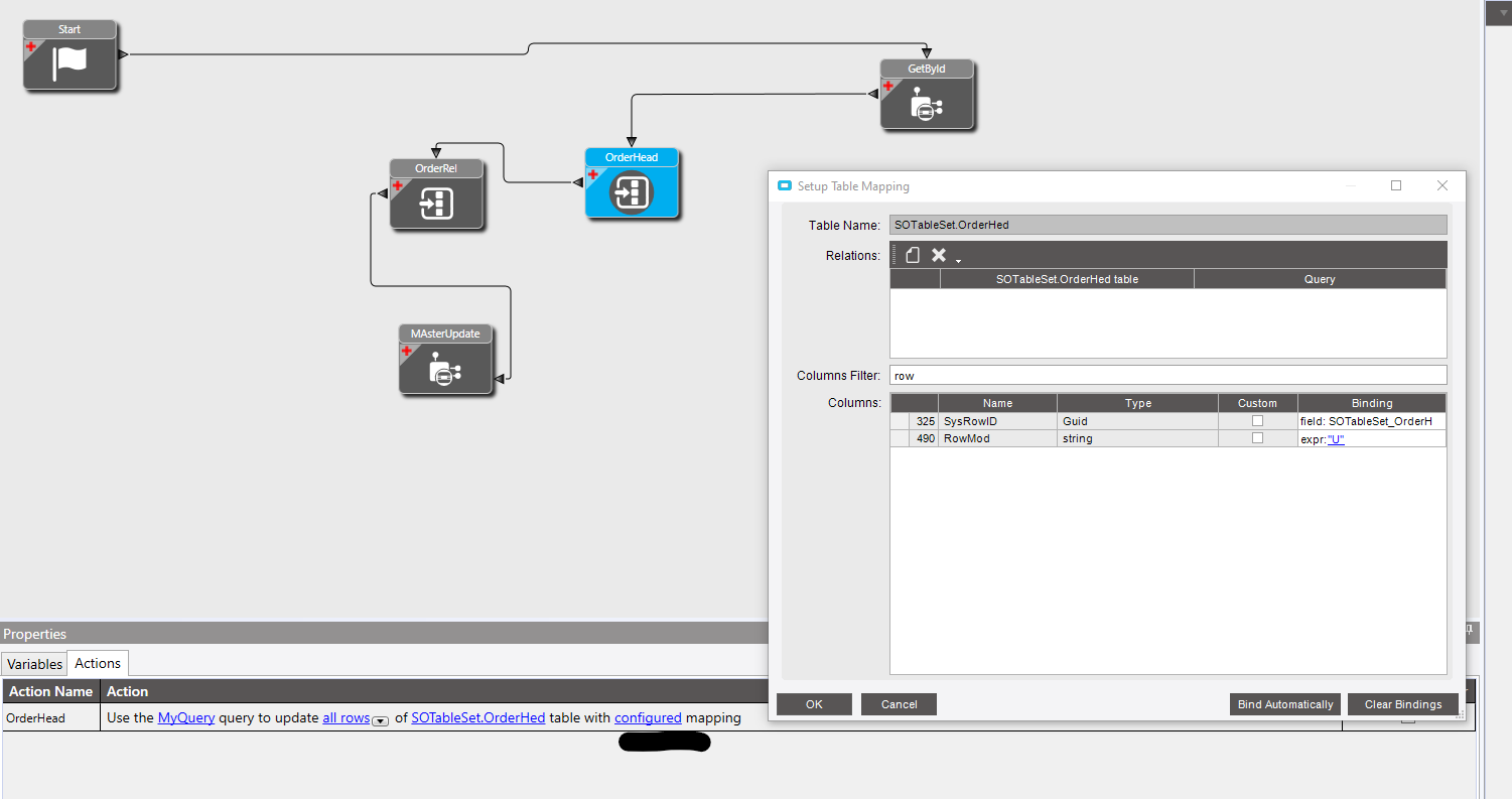

Set RowMod = “U” or “A” as needed in the update table by query widget.

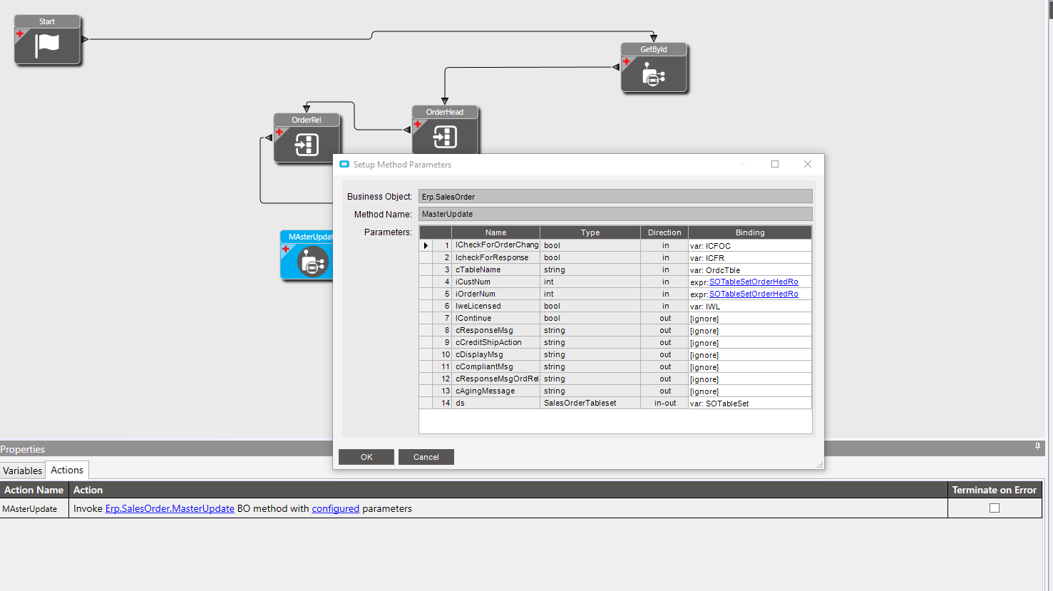

Here’s one of the ones I did.
