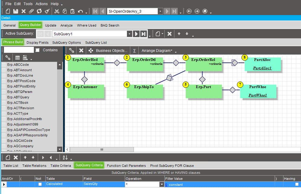

The join to UD fields is a single inner join it should have minimal performance impact. What does the query look like?
Agreed, I’ve never seen this issue before. The +criteria is “Open…” on all three Order tables plus the SubQuery Criteria you can see if the capture. There is one UD field from Part and two from OrderHed in this BAQ. There is about 14 calculated columns and about 50-ish total columns. On the plus side I cleaned up some chaff from the E9 verison.
