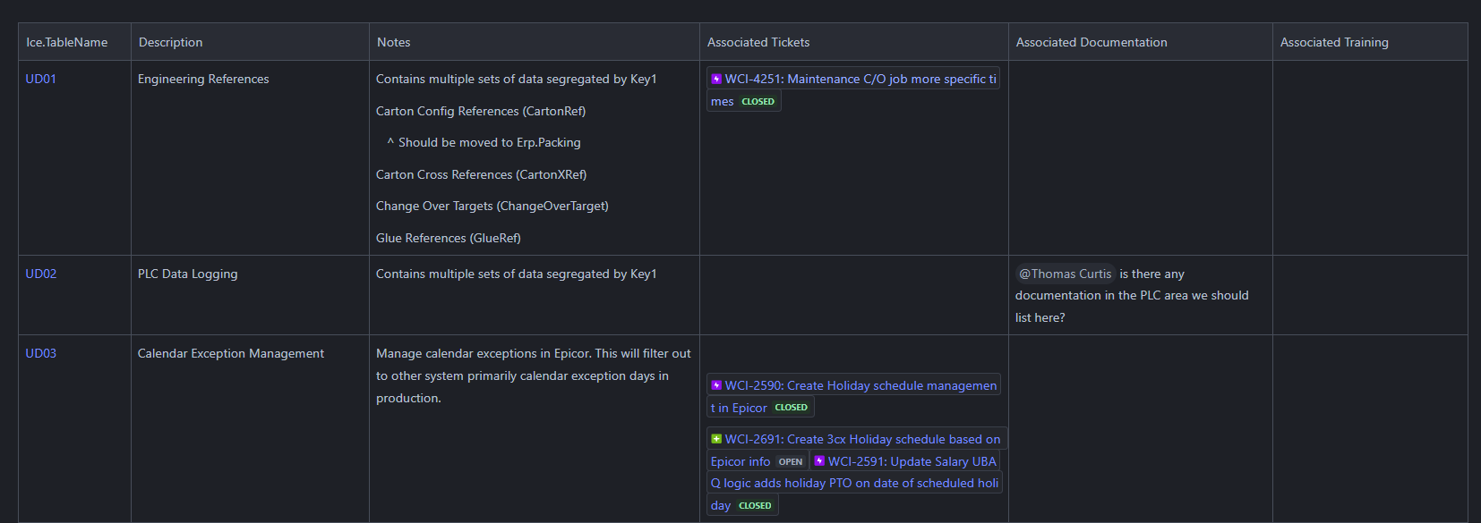

Not that I’m aware of. I just keep a confluence document of what tables are what, and what they are used for and which Jira issues are related to them. Works fine enough. Eventually I just know what they are sort of like some of Epicors’ obscurely named tables.
