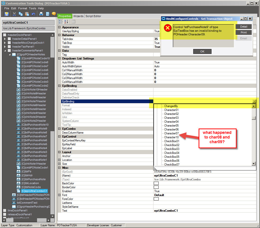

We have several customizations with ud fields that were used from base tables, eg POHeader.Character01, etc.
It’s as if some of these ud fields converted ok and then others didn’t. See screenshot. I don’t have all of my UD fields available for binding now, there’s skips in sequential numbering from the Character07 straight to Character10.
I’m trying to determine how best to deal with this moving forward. I think i can add the missing UD fields for the lost ones via Extended UD Table Maintenance. It seems like then i’ll have some _c ones and then others that aren’t. Seems weird.
Has anyone else dealt with this and have any recommendations on best practice?

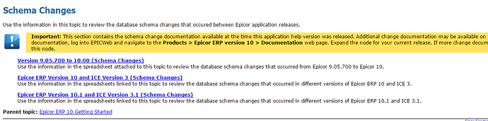

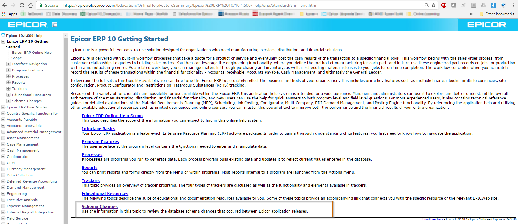

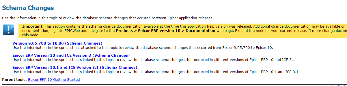

We include any schema change (new, removed, changed) columns and tables in the built in application help.
To access the hosted application help on epicweb, you can click here:
https://epicweb.epicor.com/Education/OnlineHelpFeatureSummary/Epicor%20ERP%2010/10.1.500/Help/enu/Standard/snm_enu.htm
FYI: it was obsoleted between E905 and 10.0.600.

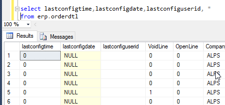

In E10, one can query the table erp.OrderDtl for fields LastConfigDate, LastConfigTime, and/or LastConfigUserID to determine if it was configured. Based on my reading of the SCR that obsoleted HasBeenConfigured, those fields will only be populated it if was configured.
Thanks, Nathan. That’s the info that I need.
