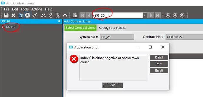

I am having same issue as reported by @snguyen and tried your workaround code. Still receiving “Index 0 is either negative or above rows count” error. Any thought

Hello, @shantocthomas.
First, remove this line: oTrans.GetByID(Value,"","","",""); because it serves the same purpose as your last line. If that doesn’t fix the problem when you save, close, and reopen, try adding this to the onload method of a not-yet-customized version of the form to determine if the error comes from this or another part of your code.
Thanks Joseph! I was tearing my hair out with this issue this morning. Great solution!
Thanks @josephmoeller Its Worked well.
