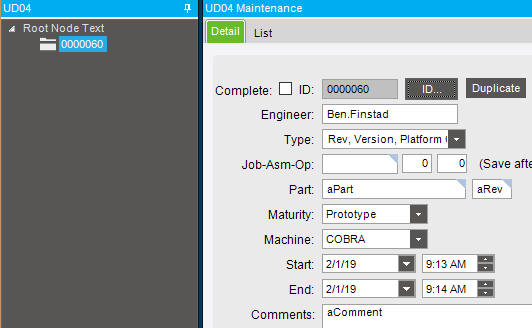

The original record (0000060):
When duplicated, the new record (0000061) appears to work as expected.
I saved and refreshed with no issues to confirm.
But when I clear and reopen the new record, all the fields that should have been copied from the ‘Fill table by query’ tile are empty. The fields set via ‘Set field’ tiles keep their correct values though.
