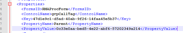

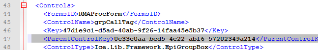

Since I haven’t learned C# yet, I exported the xml, and edited in Notepad++. Doing a find-all for grpCallTag in the xml file, it shows up 13 times. I changed the guid in 2 places.
The first was the <ParentControlKey>, which I changed from the old parent to the new parent. The 2nd place was the <PropertyValue> field under the Parent <PropertyName>.

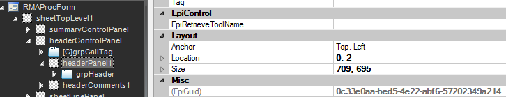

Old Parent:

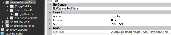

New Parent:

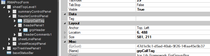

“new” Group:
It was originally showing on top of both the Detail and Comments panels, and I wanted to show only on detail:

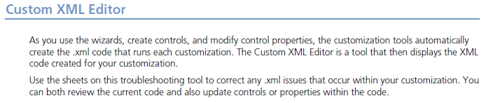

Just noticed in the ICE Customization User Guide that we can edit XML in Epicor, so no need for Notepad++ anymore, and we can edit the parent key in one spot. Score for RTM :slight_smile:
